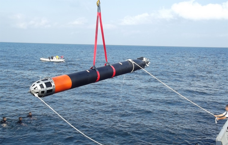

With ATMACA probably the most important weapon our Navy needs, big news, great milestone for the Defence Industry.
Btw, are there any specs revealed for AKYA?
Of the technical specifications:
Length: 7 m
Diameter: 533 mm
Weight: 1.2 tons
Propulsion system: electric
Battery: It is estimated that Silver Oxide-Zinc batteries are used
Range: 15 km
Top speed: 40 nautical miles / hr
Propulsion system: Two propellers rotate in the opposite direction in one axis
Instructions: Launch and forget an active / passive acoustic sonar
Warhead weight: expected to be between 350-380 kg
Target: dual-purpose (surface / subsurface)
Length: 7 m
Diameter: 533 mm
Weight: 1.2 tons
Range: 15 km
Isn't 15 KMs a little bit small well these might be range on paper but according to wiki DM2A4, F21 have a range of 50 KMs.
Sometimes specs mentioned on websites or articles etc are not accurate but only hypothetical since range in reality remains classified so either this info is only for the public or the range does not matter
Here's original source for specs (in turkish) :
The Netherlands Correspondent
2,807
15 6,187
I think the 15 km range is with max speed, so what the range will be with low speed maybe 50 km+.
15 km in which speed, mode?
In wake homing 15-20 km can be considered decent due to zig-zag pattern
Also, 15 km was only a test value of a prototype, in fact not even a prototype but maybe a technology demonstator which propulsion, propeller, hull form, noise, guidance etc was proven, meant to measure several variables.
