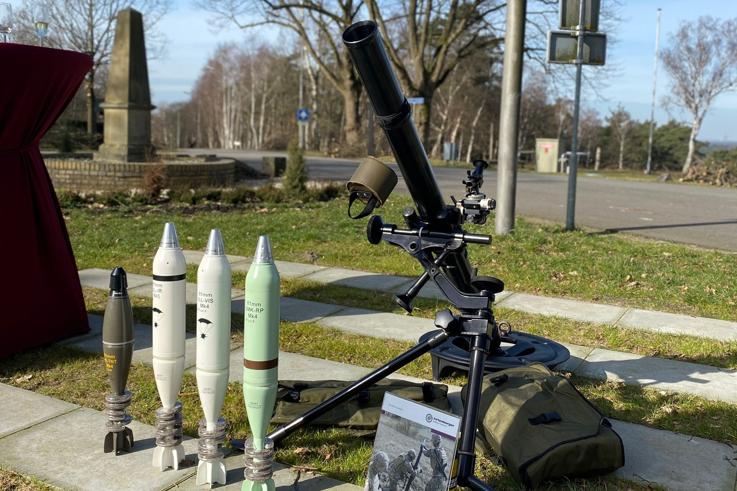

The contract signing ceremony on February 25 2021 was held in t`Harde, the home of the Dutch Artillery. (Image: Hirtenberger)

The weapon system is the Hirtenberger M8 – 1365 bipod 81 mm mortar with a blast deflector in 81 mm calibre with a system weight of 40.2 kilograms. The 1.365 metre long barrel allows ranges of up to 6.7 kilometres (with Hirtenberger HE Mk4 ammunition).
Technical data M8 – 1365 according to company brochure
Calibre81 mm
Max. range with Hirtenberger HE Mk4 ammunition6,669 m
Max. operating gas pressure100 MPa
Total weight40.2 kg
Weight of the barrel14.9 kg
Weight of the bipod12.8 kg
Weight of the base plate12.5 kg
Barrel length, overall1,482 mm
Barrel length, ballistic1,365 mm
Diameter of base plate547 mm
