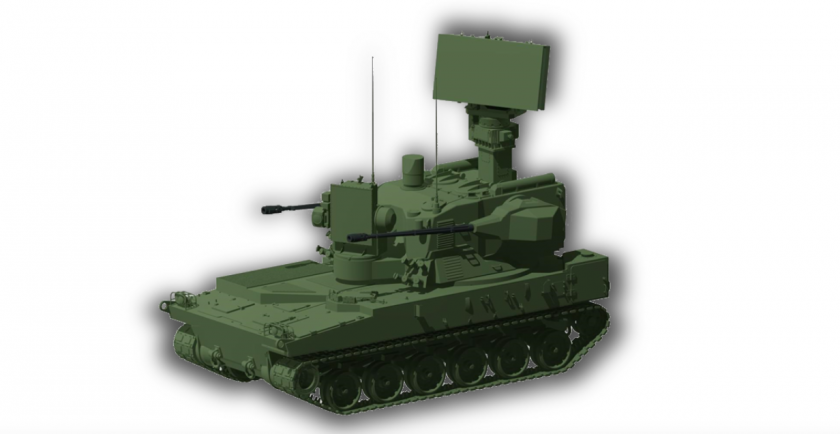

840_472_matched__qdegux_LOARA2.0
One of the propositions for SONA. Graphic: PIT-RADWAR

From Loara to Sona
The last proposal involves the creation of an integrated air defence system on a single, tracked chassis. This is a response to the Sona programme requirement. The procurement programme in question assumes that a system capable of protecting armoured elements from the UAVs. The system is also to work in the C-RAM domain (which is a novelty in the Polish military). Just recently the Armament Inspectorate has begun a technical dialogue within that scope. The dialogue has been joined by the PGZ Group and its businesses the know-how and solutions of which can be viewed as a response to the Ordering Party’s requirements. PIT-RADWAR is one of the participating businesses, with its complex 35 mm gun solution and broad know-how on the integration of such systems. All of that expertise would make it possible to create the target solution with sensors and effectors integrated on a single platform that could be selected as the primary carrier for the system. Experience gathered during the development of the OSU-35K naval gun could be very useful in the process of creating the Sona solution components.
Read more: From Loara To a 35 mm AAA System. PIT-RADWAR’s Contribution to the “Noteć” Programme
One of the options would involve a system fitted with a tracking radar, optronic sensor, and early detection radar, integrated on a single vehicular platform. Those sensors, meanwhile, would be delivering data to the fire control system. The whole solution could be armed with two 35 mm guns using ABM and sabot rounds. Enriching this arsenal with Piorun or Piorun 2 anti-aircraft missiles would also be justified. A system based on similar assumptions could also accompany the armoured/mechanized elements replacing the scarce quantity of the ZSU-23-4MP Biala platforms armed with four 23 mm guns and 4 Grom missiles.
PIT-RADWAR representatives stress the fact that the tracked-system offer is a variant-based one, thus it can be completely tailored to the user requirements. It is possible to install a differently configured turret system on a selected carrier platform - for instance, with a single cannon, missile launchers, and optronic/radar sensor suite.
The new 35 mm self-propelled system should replace all of the post-soviet ZSU-23-4 Shilka vehicles, as well as the Polish derivative - the combined SAM/AAA ZSU-23-4MP Biała solution. Image: DPI MON
A vehicle as such would be a bit less complex, cheaper, yet it would also retain a high degree of combat capabilities. Both, when used against conventional fixed- or rotary-wing assets, as well as against maneuvering and non-maneuvering small size threats, UAVs included. This would be possible thanks to the high accuracy of the gun and thanks to the use of the programmable rounds. Ammunition as such makes it possible to effectively neutralize the given target with a number of rounds smaller than in the case of conventional ammo.
Fire control vehicles fitted with the Bystra radars and optronic suites could be used to designate targets for systems as such. It is also possible to create different solutions (weapons/support assets) in the Sona system, depending on the requirements of the Ordering Party.
