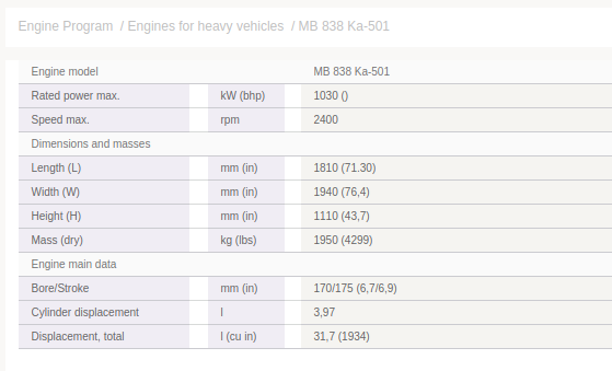

Not an expert, but the dry weight of the Korean diesel engine is said to be ~500 kg heavier than the MTU. As a long stroke engine it‘s also bigger in dimensions.
MTU designs and builds diesel engines for armored tracked vehicles since 1918. That‘s over 100 years of experience and one premier example of German engineering, not alien tech, they‘re simply very good at what their doing.
Yeah, that's what I feared. A lot of the quality of these strategic technologies seems to simply be a function of decades, even centuries, of experience.

and whats problem if its a little bit heavier? total mass of tank is more than 55 tons 500 kilo wont be a problem..
or does it affect the engine itlself indirectly (vibration etc)

Not really a problem, the MTU is superior in power to weight ratio.
K2 suits Korean mountainous terrain and has less side armor (55 tonnes weight). Also lighter due to autoloader and therefore 3 instead of 4 crew men.
Altay T1 is a lot heavier armored like European MBT (65 tonnes) with 4 men crew. Still a 1,500 hp engine provides enough power. Dunno the specs of T2 or T3.
Main concern is IMO the reliability and durability of transmission gear.
