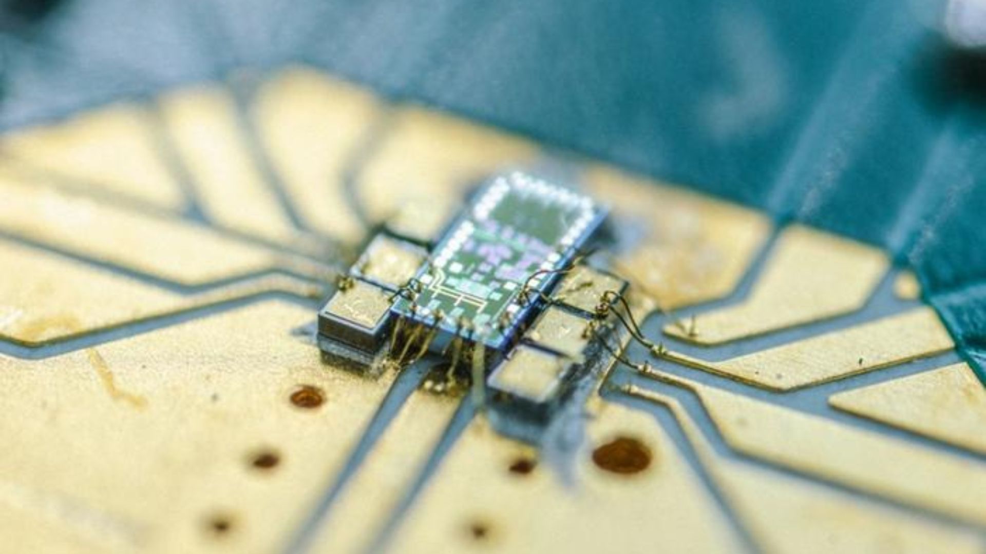

UK builds world’s smallest light detector to shrink quantum computers​
Researchers at the University of Bristol in the UK have developed the world’s smallest quantum light detector on a silicon chip. The tiny detector, which is thinner than the width of a human hair, can help scale up quantum technology, a university press release said.
In the 1960s, the field of electronics took a major leap after scientists turned large transistors into small microchips that could be built cheaply. Since the detection of the light signal or quantum bits has been minimized, a similar fate can now be expected for quantum computers.
Current designs of quantum computers are for massive machines that occupy rooms and need freezing temperatures to operate. If, like its binary counterpart, a quantum computer has to be deployed at scale, the device itself needs to be shrunken in size and made easier to switch on and operate.
The research team led by Jonathan Matthews, a university professor and the Director of Quantum Engineering Technology Labs, has taken the first step toward miniaturizing the quantum computer.
Homodyne detectors​

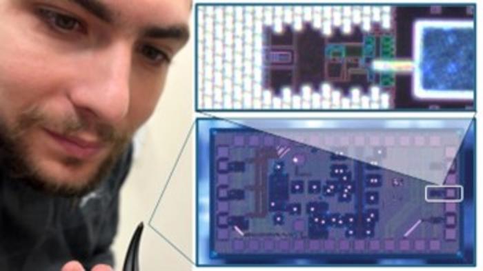

The research team showed first glimpses of its work in 2021 when it linked a photonics chip with an electronics one and increased the speed of quantum light detection. Three years later, they integrated the two components onto a single chip, reducing the detection speed by a factor of 10 and the footprint by a factor of 50.
The quantum light detector integrated into the chip and its circuitry measures 0.0031 inches (80 micrometers) by 0.0086 inches (220 micrometers). For comparison, the average thickness of human hair is 0.0019 inches (50 micrometers).
Matthews added in the press release that the detector is known as a homodyne detector. It is extensively used in quantum optics since it operates at room temperature and in highly sensitive sensors such as gravitational wave detectors.
Giacomo Ferranti holds the silicon ePIC quantum chip. On the right is a magnified image of the chip. Image credit: University of Bristol
The advantage of the smaller detector is quicker detection of quantum light, which improves the speed of communication within the system and, hence, the overall operational speed of the quantum computer.
