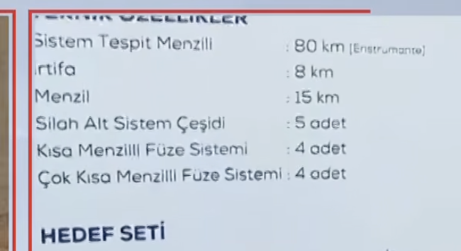

Looks like the instrumented range for the aesa radars(Kalkan) on Gürz (Airforce Variant) is 80km.
