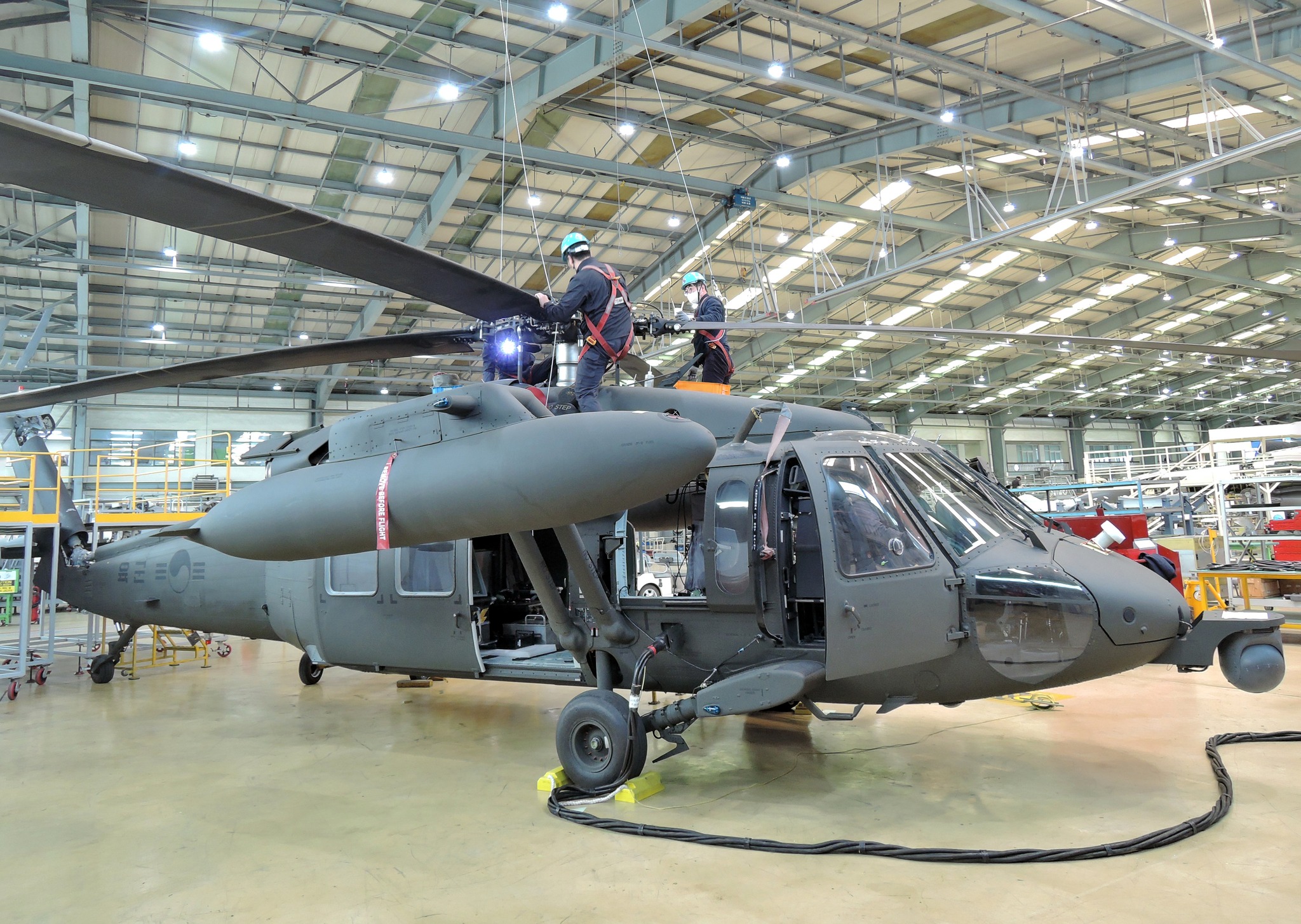

South Korea has licensed and produced more than 130 UH-60Ps since the 1990s. These helicopters are operated by several branches of the military, including the Army, Navy, and Air Force, with the Air Force in particular converting some of its fleet to SAR and operating them in SART.
However, over time, there was growing concern that the UH/HH60s operated by the South Korean military were becoming obsolete and difficult to support the penetration of the Army and Air Force's special warfare units. To address this, a project to upgrade 36 helicopters for infiltration by special warfare forces will begin in earnest this year.
The companies that will carry out this upgrade program will be selected by KAI and Korean Air, respectively, competing in a consortium.
First, it is the Korean Air consortium with LIG Nex1,Collins Aerospace. Korean Air is a company with experience in producing UH-60P licenses and is in charge of system integration, design, and testing, while LIG Nex1 is in charge of survival and communication equipment. LIG Nex1 will localize and present DIRCM together with BIRD Aerospace Systems of Israel.
Most media expect it to be based on SPREOS DIRCM. Other than this, LIG Nex1 is expected to supply survival and communication equipment based on its experience in developing electronic equipment used in Surion transport helicopters and Miron attack helicopters. Collins Aerospace is responsible for improving navigation systems and cockpit.
The competitors are KAI, Hanwha Systems, and Elbit Systems consortium. Like Korean Air, KAI oversees the entire program and is responsible for system development and integration. Hanwha Systems and Elbit Systems are responsible for Self-Protection Suits and Airframe Modification.
Hanwha System has been presenting its DIRCM, MWR, and RWR. In particular, DRICM is likely to be selected first for the improvement of military helicopters in South Korea in the future as equipment that currently goes into the C-130H 2nd performance improvement program.
It is expected to be in charge of the integration of Elbit Systems Digital Cockpit and several avionics.
The period of this performance improvement program is seven years from the start of development, so it will be completed by the early 30s.

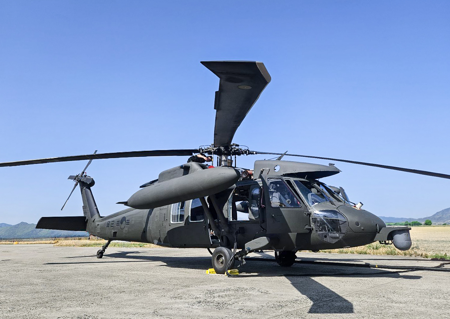

UH/HH-60 MLU Program Officially Begins.

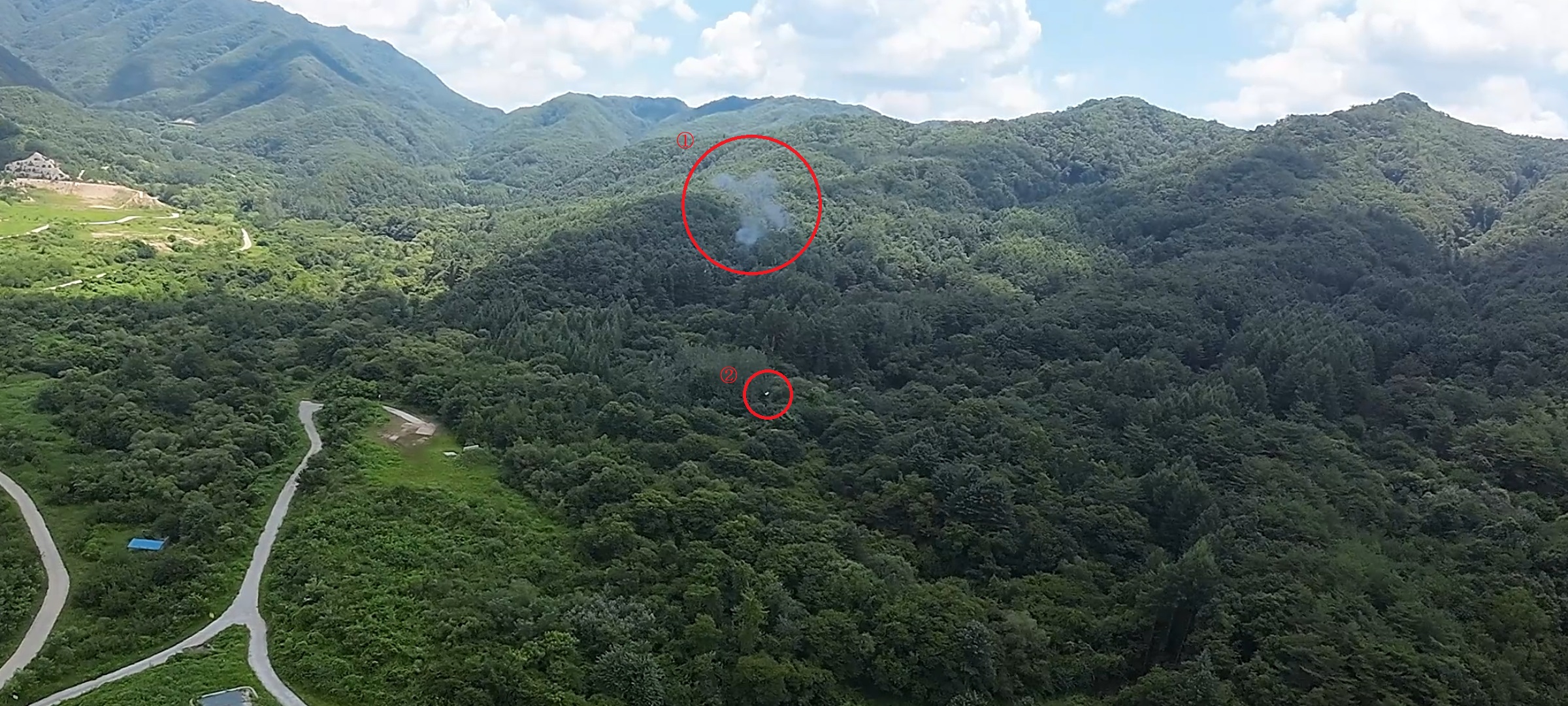

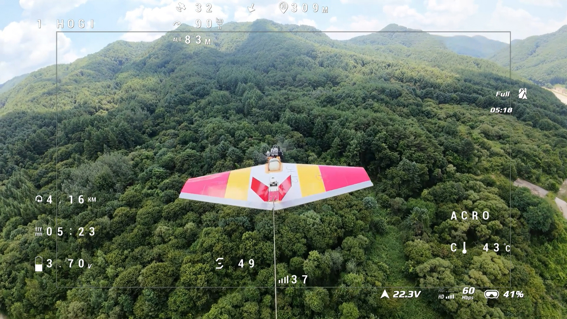

Combat experiment deploying and operating FPV drones from the Surion.
Surion (KUH-1) and FPV suicide drone linked 'enemy UAV countermeasure training'. The training was conducted by mid-air launching an FPV loitering munition (suicide drone) equipped with an explosive charge from a Surion helicopter to track and strike an aerial target drone (RC-MAT). The focus was on substantively confirming the operational viability of the suicide UAV, particularly the procedures for mid-air launch and remote strike.
The aerial target drone (RC-MAT), which is generating smoke after being struck by the FPV loitering munition (① in the red circle), is falling along with its wreckage (② in the red circle).

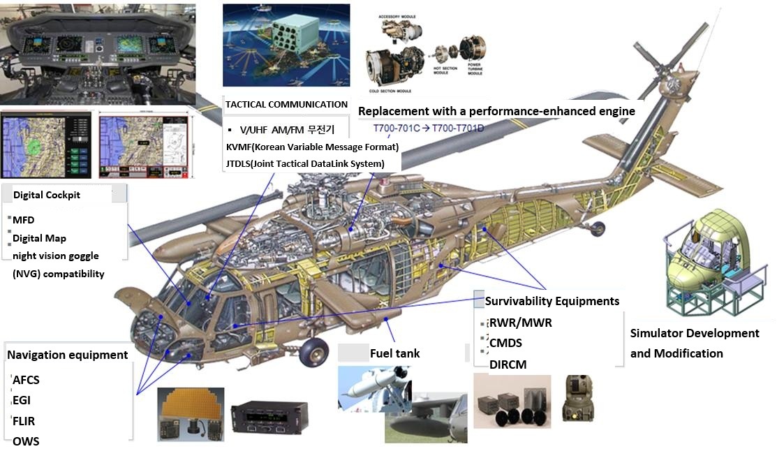

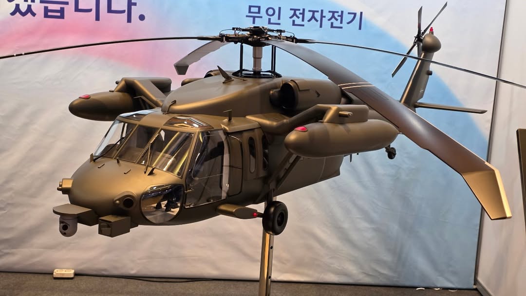

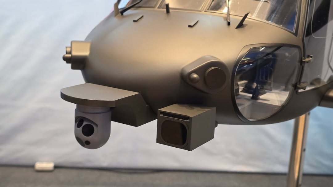

The model displayed in the UH/HH-60 MLU Program, which the LIG Nex1/Korean Air consortium will undertake, has some unusual aspects.
The box-shaped structure next to the EO/IR is a type of LIDAR called OWS.
OWS(Obstacles Warning System)is highly beneficial for low-altitude flight because it can detect objects such as power lines that are undetectable even by radar. Originally, the military wanted to introduce the MMR (Multi Mode Radar) mounted on US Army MH-60 helicopters, but since the US refused to export the AN/APQ-187 radar, it appears this system will be installed instead. While it may not be as advanced as the AN/APQ-187, I appreciate that the OWS can prevent risks by detecting transmission lines and other structures in South Korea's mountainous terrain. It will also be helpful for low-altitude flight during infiltration into North Korean territory.
I've been wondering what OWS is, and now I finally know.

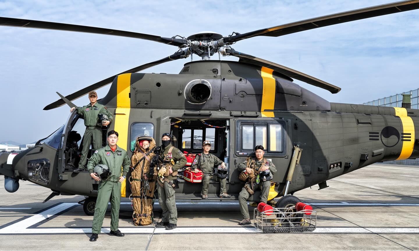

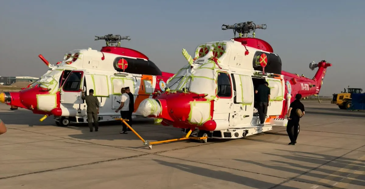

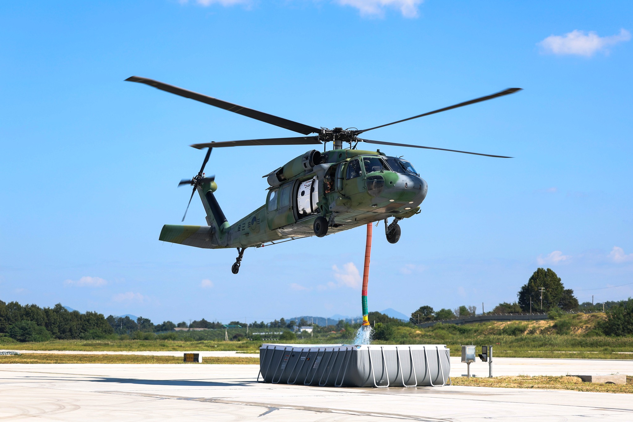

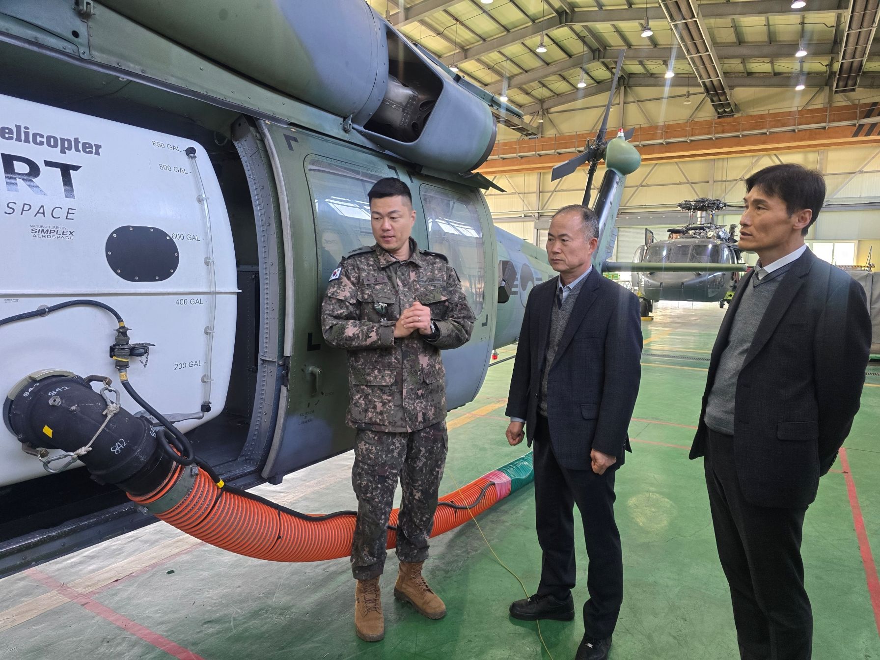

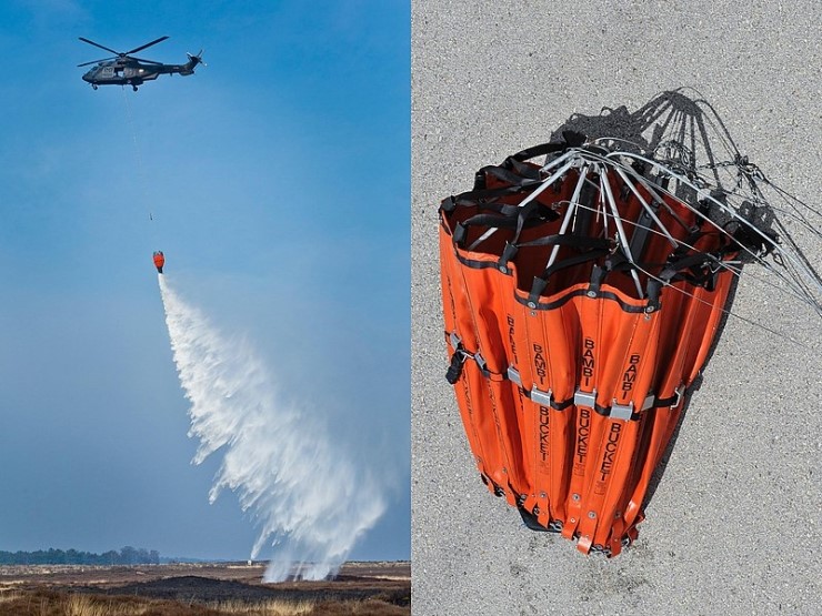

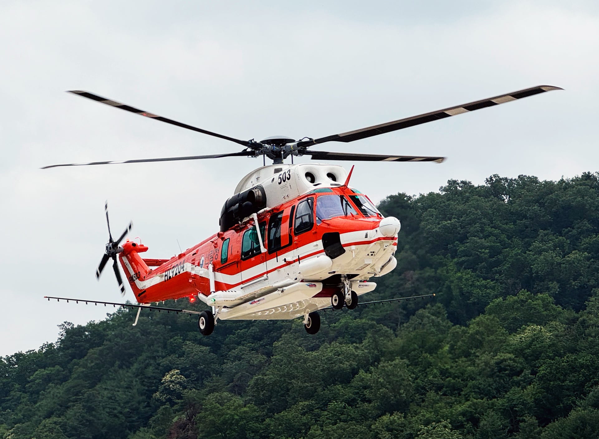

The climate of the Korean Peninsula is characterized by heavy rainfall in the summer and dry weather in the spring, fall, and winter. Dry weather increases the risk of wildfires.. The simultaneous wildfires that broke out across the country last March were truly terrifying. The Forest Service and firefighting helicopters alone are often insufficient to extinguish large wildfires. That is why the military also mobilizes all available helicopters.
Usually, a Bambi bucket is attached to the outside of the helicopter to drop water, but this approach has many problems. If the helicopter hovers over a water source to fill the bucket and makes a mistake, it could crash, or it might hit an obstacle like a power line tower while flying with the bucket full...
Of course, military helicopters weren’t originally intended for this kind of mission, so there’s often no choice but to use them. However, since climate change is expected to lead to an increase in large-scale wildfires in the future, we need to have a plan in place.
Therefore, the helicopter is modified by replacing the internal water tank with a removable, high-capacity one and installing an electronically controlled release mechanism to improve accuracy.
The Surion has been equipped with a 3,000-liter water tank, which is larger than the previous capacity.

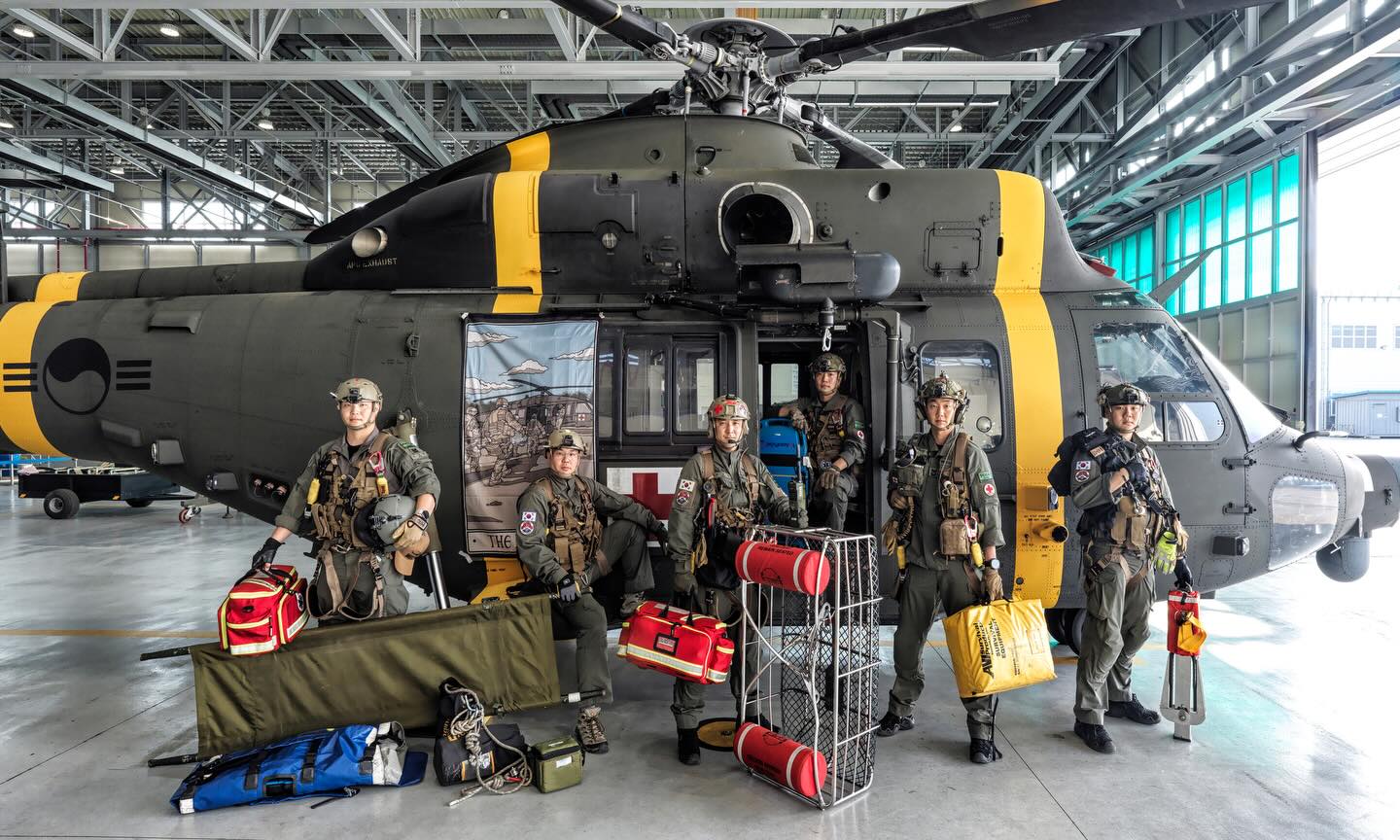

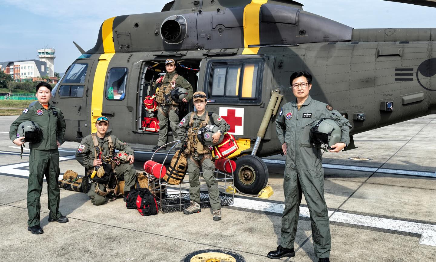

ROKA MEDION (Medevac Unit) . In accordance with the Armistice Agreement, aircraft authorized to transport personnel of the United Nations Command Military Armistice Commission or to evacuate casualties within the DMZ and the Han River Estuary (HRE) area specified in the Agreement must be marked with three yellow stripes.

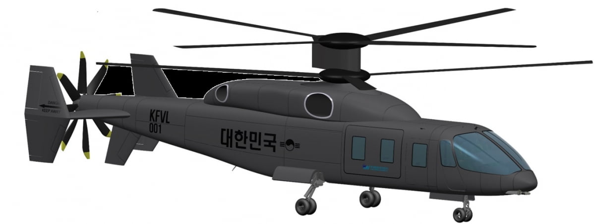

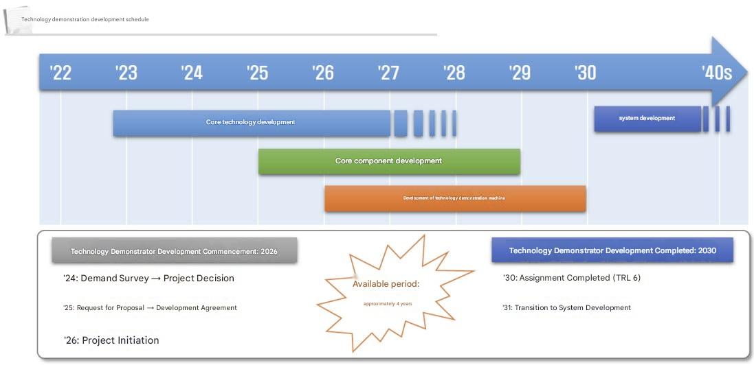

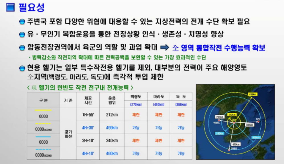

This project was originally known as XUH. The XUH program is centered on developing a high-speed, medium-lift utility helicopter to replace the UH-60s currently operated by the South Korean Army. The goal is to acquire a helicopter through domestic research and development that meets the South Korean Army’s requirements—which prioritize joint operations with the U.S. Army and demand world-class performance.

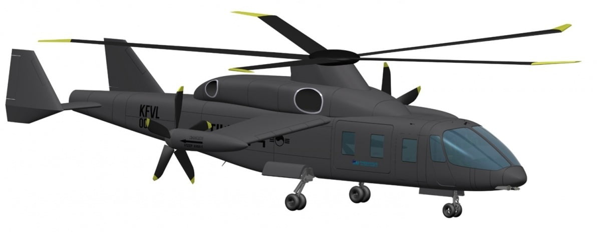

At a symposium hosted by KSAS in 2024, KAI presented a preliminary study on the development of a next-generation utility helicopter.Previous studies have identified three configurations that meet the requirements for future medium-sized helicopters, and the core of the plan is for the Army to select one of these configurations, conduct a technical validation, and proceed to system development.
Compound type
Tiltrotor type
Coaxial-Pusher type
Looking at the images above, you can probably picture the next-generation helicopters currently being developed by leading aerospace companies.
KAI is conducting research with all three models in mind; once the Army selects the final model, a technology demonstrator will be built and flown, after which system development will begin.
The purpose of this program is to expand the operational range of the Army’s existing helicopters and strengthen the Army’s role in future battlefield environments. As can be seen on the map in the image above, this highlights the problem that, with the exception of some of the Army’s special-purpose helicopters, they cannot be deployed across the entire Korean Peninsula. Troop numbers are steadily declining, while the operational areas we must cover are expanding; our existing helicopters are simply not enough to meet these demands. Therefore, it can be argued that we need assets such as long-range, high-speed medium helicopters to address this shortfall.
But the problem, as always, is money. We are already investing massive amounts of money in procuring equipment to strengthen our defense capabilities, so we don’t have the resources to take on a new development program. It looks like KAI is teaming up with Bell to collaborate. We'll keep an eye on how things unfold.
