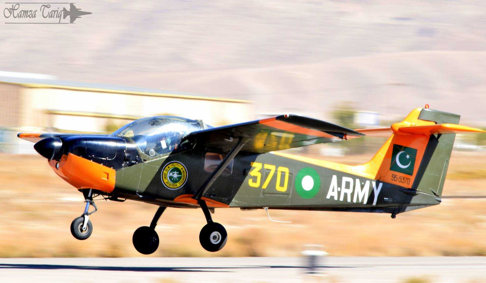

Besides Pakistan Air Force, as many as 174 Mushshaks were procured by Pakistan Army Aviation for air support operations, including forward air controlling, artillery spotting and field liaison duties.
