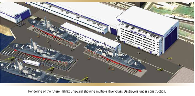

A rendering of the Halifax Shipyard with multiple River Class under construction.

Latest artwork of the RCD from Irving with design changes. Note the MK 54 main gun.

The gun depiction in that artwork image does not look radically different from the guns in any other images of the River Class. With respect, it does not appear to me to illustrate the Mk 54 any more than the Leonardo gun.
Further, I have yet to read anything contrary to this April-2021 Leonardo press release indicating they were awarded a contract to supply 4 x 127mm guns to the RCN.
I have been looking, but have as of yet to read any official RCN, nor BAE confirmation that the BAE Mk 54 main gun has been selected, nor have I read of any official RCN nor Leonardo document suggesting the Leonardo contract to provide quantity four 127mm guns to the RCN has been cancelled. Presumably we will know better as to any hypothetical gun selection changes later this year (2026) in the Final Critical Design Review. ...
Edit: I also type the above with the understanding that guns such as a BAE Mk54 5-inch gun, and a Leonardo 127mm gun, typically have long lead times for procurement. I am not 100% certain of that, but it is what I suspect. This, if correct, suggests to me further that a BAE gun for batch-1 is less likely, unless a contract awarded soon (or already awarded an not publicized).
Frankly, as time goes by with no official confirmation, I am become more skeptical that a BAE gun is being selected instead (of the Leonardo) for batch-1 of the River Class.

it's good to be skeptical, just as its good to question one Sea Ram instead of two.
