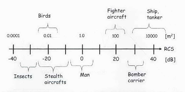

We still don't know anything about any of those, but just to give some context, BÜRFİS will have more T/R modules than AN/APG-81, it will use GaN and probably more power
Frontal RCS of F-35 will be better compared to first blocks of TF-X and probably similar for 2nd block.
For having twice less detection distance, you must have 16 times less RCS, so that difference doesn't matter that much either,
Let's say for a given moment TF-X has frontal point RCS of -25dBsm and F-35 has -35dBsm, which would translate into 0.005m² and 0.0005m² respectively, at those ranges, F-35 would be able to see TF-X around (1/16/16) (so 150/4 km, which is 37.5km, 0.001 part doesn't really change anything so we can round that up)
If TF-X has a radar which is exactly on par with AN/APG-81, it would be able to see F-35 around 20-21 km, but we know that if there is no f*ck up in radar algorithm for BÜRFİS, both should be able to see eachother in similar distance, probably TF-X detecting F-35 earlier than F-35 detecting TF-X.
But this is kind of irrelevant, as at those ranges both would be using the sensory input from EOTS and BEOS/IRST if weather is not in a really really bad condition, which I think TF-X does have an advantage here by having 2 different sensors.
Also, you don't have to switch modes from radar to IR as sensor fusion automatically does that, friendly forces present are also a big factor as with datalinks, fusion can be more precise and rich.
Actually we don't have to compare F-35 with TF-X, why would we? We won't go into a war with NATO or Greece, our TF-X and their F-35 will always fly with Luneberg lenses, and even if a war with (only Greece, not NATO), we would have data superiority as we have lot more platforms that can be used to create a picture of the situation and use them by datalinks.
Our main threat in the area (in the future) would be Su-75s, Su-57, or maybe J-35s, and I am sure that TF-X will be superior to all of those stated.
Also keep in mind that combat is multi directional and RCS is a really dependent factor, so comparison of RCS in smaller levels, like 0.005 against 0.0005 doesn't really matter in the environment of EW contested area and just the sheer number of forces in the area, stealth fighter won't be able to face an enemy just from the front, this is the reality for every fighter
