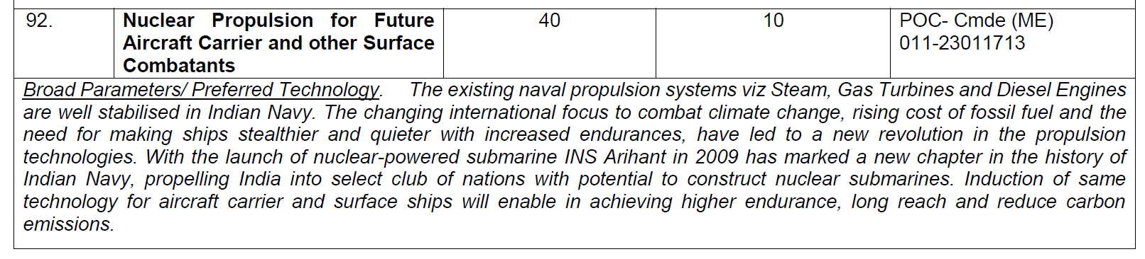

The most recent Capability Roadmap document makes it a point to mention that nuclear propulsion for surface ships (including carriers) is very much in the Navy's plans, but whether they decide to go for a nuclear carrier(s) or not might depend on timelines.
