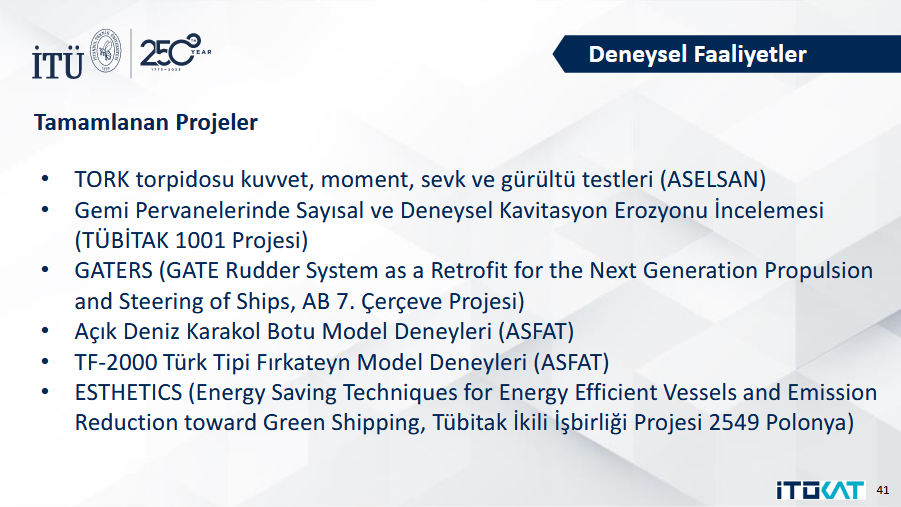

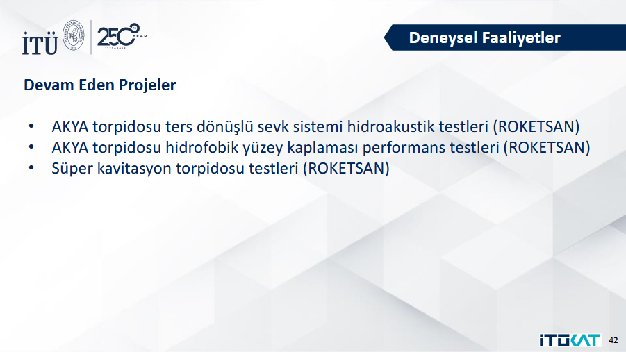

It was only mentioned as "intentions" in previous years (some of which go back several years, when Roketsan implied intended projects in a presentation). Now it is confirmed by Roketsan's CEO, the super-cavitation torpedo studies have begun on the experimental technology-capability gain level. Far from making a prototype, but the first step has been done for know-how of cavitation mechanism, manoeuvring of the torpedo etc.
They haven't decided on the specific design of the torpedo, as far as I know. They're investigating the best suited approach for TN's needs.
The torpedo has a cool, but hard to spell, name that fits the possible shape. Tip: It was trademarked by Roketsan a few years ago and is a reference to the name of a fish.​
Roketsan has begun work with ITU on a super-cavitating torpedo. Roketsan has begun trials with ITU on the technology of a bubble capsule, which allows the torpedo to move inside an air bubble.

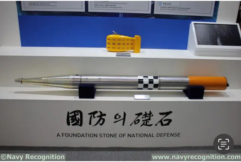

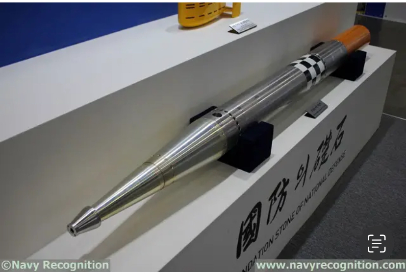

I think all relevant navies have experimented with supercavitating torpedo technology or are still doing it with no major news.
Korean „supercavitating underwater test vehicle“ on ADD stand at MADEX 2017:
High speed water tank test 2015
Supercavitating torpedos are the loudest mfers under the sea. Any competent vessel would instantly know where it is and where it's coming from and deal with it accordingly.
How? It is not easy to deal with super cavitating torpedoes. Their short range and the difficulty of guidance are real problems.
