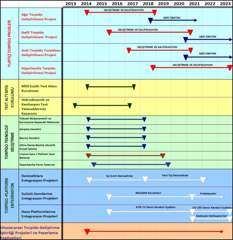

According to Aselsan Torpedo and Torpedo Countermeasure Systems Road Map, dual configuration lightweight torpido tube will be ready in 2022, TORK Training Version in 2023, Medium Class AUV & ORKA LWT in 2023-2025, TORK Live (Combat) Version in 2025, Miniature Torpedo in 2027, and the Smart Super-Cavity Torpedo will be available in 2030.
