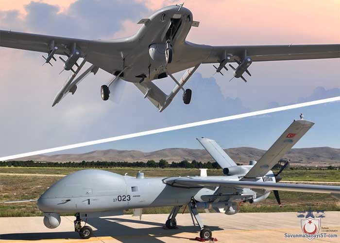

AKSUNGUR drew our crescent and flag to the sky at 20,000 feet altitude, While having completed its 59th test flight by 49 hours of endurance flight.
49 hours!
Of course these numbers will go down with weapons attached, but that's still very impressive. This will make monitoring the Aegean and Mediterranean a much easier task.

Most of the ISR payloads are on board. So Akıncı will operate +40hours flights in many types of missions.
In addition, this aircraft will fly with more powerful engines in the coming years. To see the full potential in terms of structural limits, we need to look at the maximum carry weights of the under-wing pylons.

Aksungur just broke Turkey’s endurance record. 49 hours is really something!
Looking forward to a competition between TAI and Bayraktar to break each other’s records ;)

Turkey never really had long-range bombers – crazy that we partly fill this gap today with armed drones. I personally wonder why AKSUNGUR receives so much less attention than AKINCI – that is my feeling anyway (subjective)-
we should have a comparison of the data here:
Specifications​
AKSUNGUR​
General characteristics
  • Capacity: 1,653 lb (750 kg) payload
  • Length: 12 m (39 ft 4 in)
  • Wingspan: 24 m (78 ft 9 in)
  • Height: 3 m (9 ft 10 in)
  • Empty weight: 1,800 kg (3,968 lb)
  • Max takeoff weight: 3,300 kg (7,275 lb)
  • Powerplant: 2 × TEI PD170 4-cylinder liquid-cooled turbo-charged horizontally-opposed piston engine, 130–160 kW (170–220 hp) each
  • Propellers: 3-bladed constant-speed pusher propeller
Performance
  • Cruise speed: 250 km/h (160 mph, 130 kn)
  • Range: 6,500 km (4,000 mi, 3,500 nmi)
  • Endurance: 40 hours
  • Service ceiling: 12,192 m (40,000 ft)
Armament
  • Hardpoints:6 with provisions to carry combinations of:
    • Missiles:
    • Rockets
      • Possibly ROKETSAN DSH(Anti Submarine Warfare Rocket) and torpedoes for maritime patrol duties.
    • Bombs:
      • MAM-L
      • MAM-C
      • LUMTAS
      • TEBER -81 (laser guided MK-81)
      • TEBER-82 (laser guided MK-82)
      • HGK-3 (Precision Guidance Kit)
      • KGK (82) (Winged Guidance Kit)
AKINCI​
  • Capacity: * Payload:2,976 lb (1,350 kg)
    • Internal: 881 lb (400 kg)
    • External: 2,094 lb (950 kg)
  • Length: 12.5 m (41 ft 0 in)
  • Wingspan: 20 m (65 ft 7 in)
  • Height: 4.1 m (13 ft 5 in)
  • Max takeoff weight: 5,500 kg (12,125 lb)
  • Powerplant: 2 × Ivchenko-Progress Motor Sich AI-450T turboprop engines, 560 kW (750 hp) each
  • Propellers: 5-bladed composite constant-speed propelled
Performance
  • Endurance: 24 hours
Armament
Avionics
  • National AESA Radar
  • Aselsan Common Aperture Targeting System
  • Electronic Warfare Pod
http://en.c4defence.com/Archive/date-set-for-turkey-s-unmanned-fighter-jet/10220/1
As soon as the MIUS is in the air, we have a drone that is capable of replacing lighter air force.

TAI have it on their website endurance numbers with different configurations, probably very conservative numbers they give;
Mission ProfileWeight (kg)Ceiling (ft)Endurance (hrs)
Ground Attack/Maritime*75025,00012
SIGINT *15035,00024
ISR **N/A20,00049
*https://www.tusas.com/en/product/aksungur-unmanned-aerial-vehicle
**https://twitter.com/i/web/status/1301162828997550080
