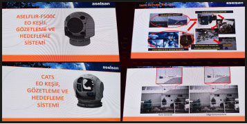

The CATS, weighs 60 kg and the MX-15D weighs 45-49 kg.

Ağırlık 61kg
*From brochure of two years ago.
A year to 1.5 years ago they have said it is less than '59'
About six months ago they have marked less than '56' at somewhere.
"Look i have googled and this numbers came up, i am very creditable and Turkish community in this forum is so dumb making up numbers".
5,797
145 26,862
Ağırlık 61kg, my source is directly from ASELSAN.
ASELFLIR-F500C’nin 56 kg olan CATS sistemine göre 6-7 kg daha hafifleyerek 50 kg civarında daha rekabetçi bir ağırlığa erişmesi planlanıyor
It is less than 56 currently.
Your source is from Aselsan's page that is made 2 years ago, or when the product first came out in 2019.
Again, Things are "developed" in Turkey, you should get used to things being " Developed". :)
F500C is going to be less than 50kg, with better capabilities compared to Wescam in same weight range, revisit the thread when F500C is introduced in 2022.

Another brochure from Aselsan says less than 59.
/www.aselsan.com.tr/CATS_ElectroOptical_Surveillance_and_Reconnaissance_System_6166.pdf
5,797
145 26,862
Again,my source is from ASELSAN.....
It is from 2019, if you are in this forum spare some time to read what people are trying to explain to you instead of repeating the same thing over and over. Otherwise if you think what you think is true then simply post it in twitter and disable the comments.
In another brochure from 2020 Aselsan marks it as "<59 kg".
In 2021 it is made to be 55-56 kg.
Don't fight for nothing, for what is obvious. We are not here to tell you lies and convince you on that.
If you want to believe it is 61 kg, then believe it. Just dont enforce it is the 'truth'.

Again, directly from ASELSAN.....
Same page in Turkish, for God's sake stop this.
From Aselsan, likely 2020;
It says "<59" are you so blinded with your ideology that you can not even think of a product can be improved over time?

If the weight of CATS compromises TB2 so much, how come it has now the new CATS and 4 x MAM-L under it’s belly instead of the 2 x MAM-Ls it was carrying originally?
Surely something has improved!!
This is the most reputable defense publication in Turkey and they quote Turkish officials. The figures from Aselsan's website is from years ago.
In the article they also mention the upcoming Aselflir-500 will weigh 50kg which is less than MX-15D's 51.4 kg.

LOL
They have taken it and watermarked the images! :ROFLMAO:
