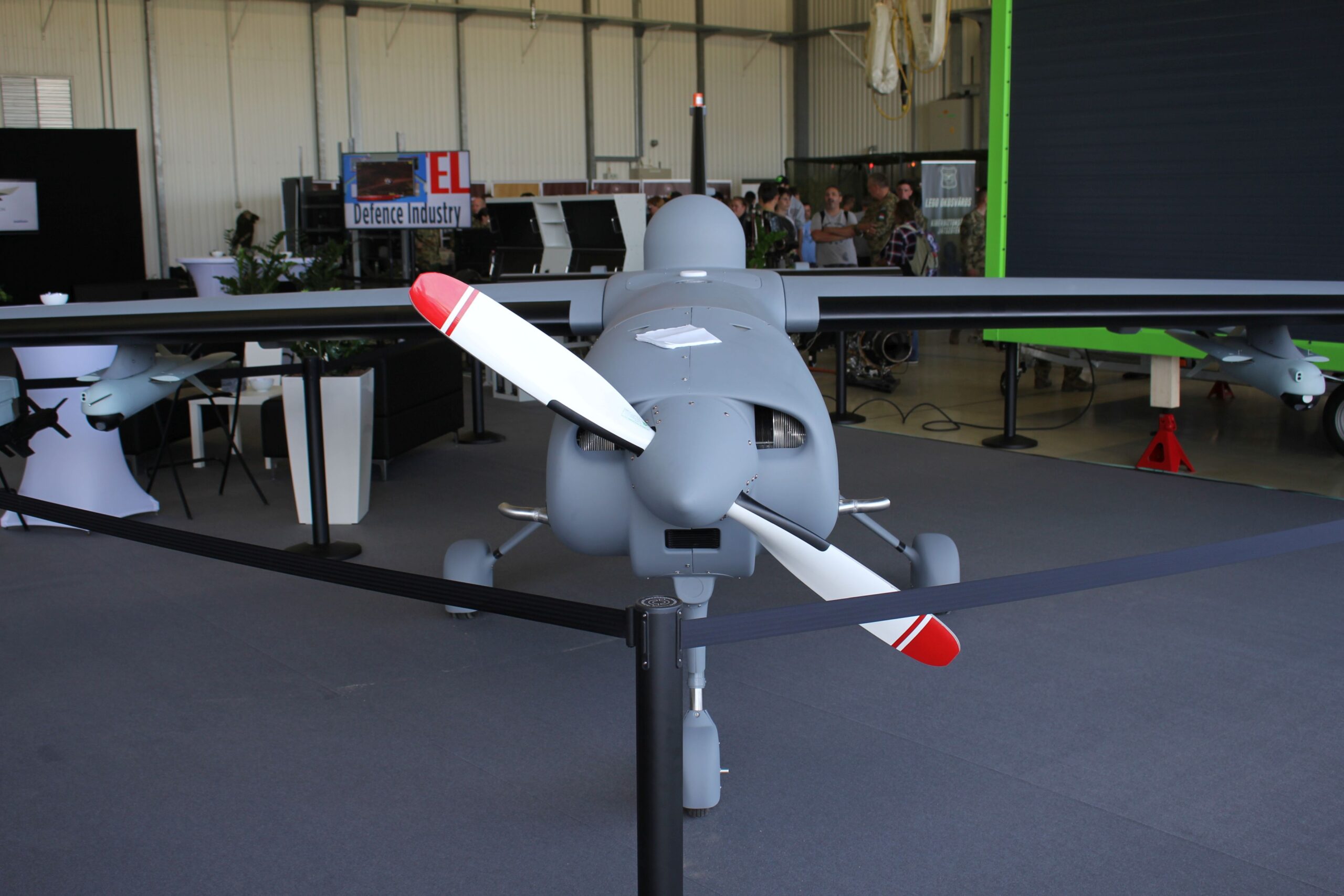

Some news related to Saudi production of Vestel Karayel
During the World Defense Show in Saudi Arabia in early March, two Saudi firms, Intra Defense Technologies and Taqnia Space signed a memorandum of understanding to develop drones with satellite communication capabilities.
“Integration of capabilities to link our UAVs to the satellites were done in cooperation with Taqnia Space, and test flights of Haboob UAV after the integration was successful and the drone was able to fly 200 km beyond line of sight due to satellite linking through its antenna,” director of Technology and Engineering Solutions, Asim Qureshi told Breaking Defense.
The Haboob, is a Saudi unmanned aerial vehicle, and it is a locally-built derivative of the Turkish drone Vestel Karayel-SU.
Presented at the Efes’22 drill as the 1st in the world.
