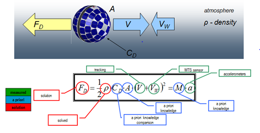

Form drag is effected by velocity squared.
So, if you double speed from .6 mach to 1.2 mach you need 4 times the power, AFAIK.
For mach 1 you need 2.78 times the power.
Help yourself with the drag equation.
Well, cruise power of AI-25TLT has less thrust than TF-6000s power (~6000lbf) divided by 4, but airframe and intakes affect it a lot
