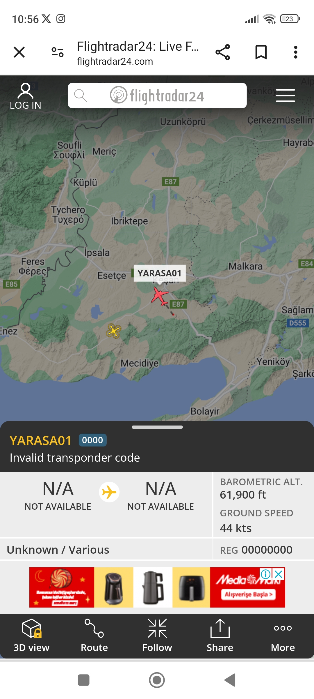

Specs look like a high altitude solar electric plane.
Could be as none of the UCAVs we have would go up that high, but Yarasa01 code must probably be a police bird. Doubt this is a test article, because of the transponder code, which looks too "operational"
Has to be like a vertical missile launch that drops back down but were there any NOTAM etc
A missile won't have an ADS-B transponder on board. I still think it was a bug, let's see.
Doubt Baykar has an RQ-4 like prototype they hid from everyone while dealing with both KE and TB-3.
