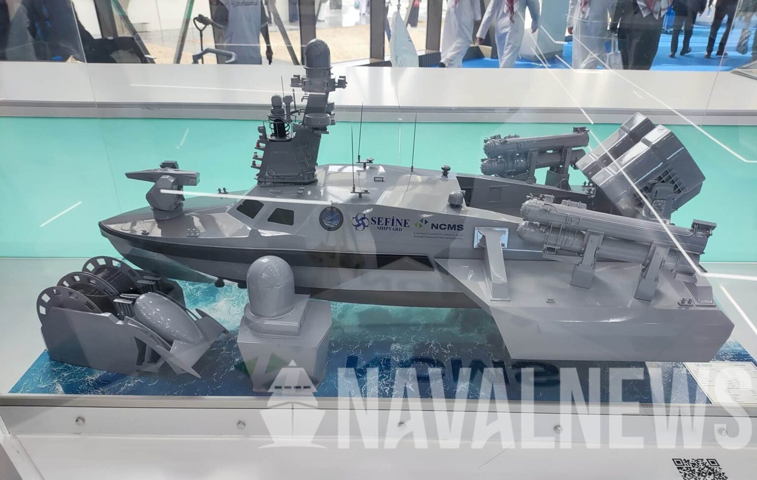

First time seeing that payload, wonder what it is.
Actual tweet from the Poles:
5,717
138 26,358
8 cell Kuzgun-KY launcher.
This could be a version intended for larger (and with possible application on land) platforms in following times. Göksur also was rumored to have fixed foundation applications for certain platforms.
I don't see any reason not to stack another box on top and make it 16 cell launcher, 16+16 is a good capability for patrol boats, corvettes, OPVs and so on. Could be even interesting if SAGE applies cold launch to this one.
