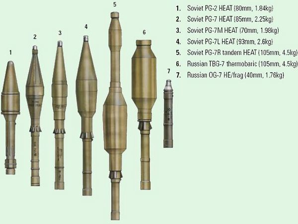

No, wing area of MAM-T is slightly smaller and geometry of the bomb is not ideal(optimized for thermobaric warhead) compared to Aselsan miniature munition.
If a miniature bomb and MAM-T is released by an F-16 with the same velocity @40k feet altitude miniature bomb will glide further.
MAM-T warhead design is similar to number 6.
