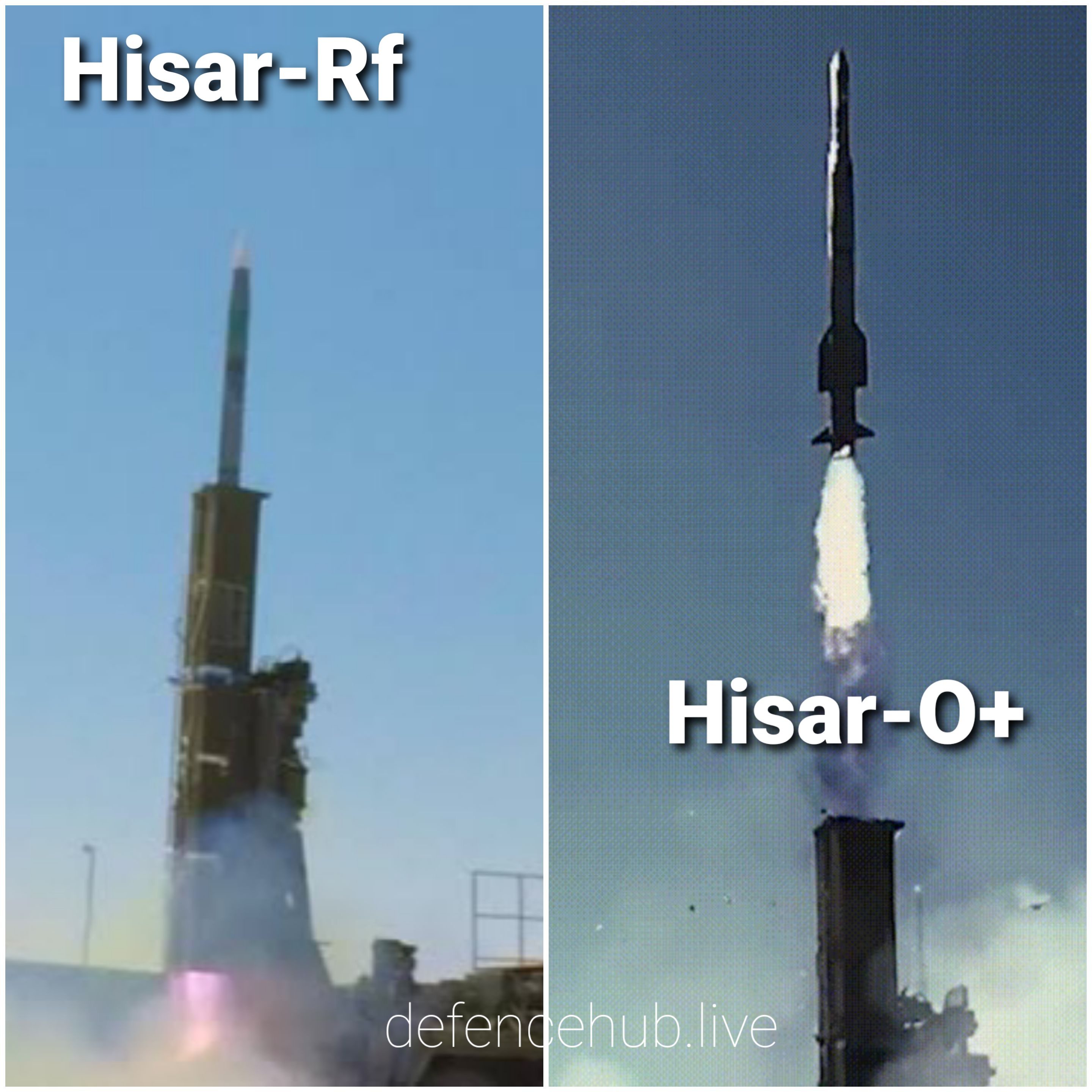

Could we quadpack Hisar-O+ RF in MDAS or would the diameter be too big?
It seems to have a similar one to ESSM but I don't know if that includes the wings are not.

My wild guesses (explanation: bullshit stuff I made with Microsoft Paint to guess graphically without any kind of calculation or aerodynamics, just for thought exercise)
Hisar A ~10 km 15000ft (~4500m)- able to reach 20000ft (~6000m) for targets overhead (the missile will be slow, target already delivering bombs or getting away, not suitable to use for most scenarios)
Hisar A+ 15km (Edit: probably 17km range, with official 26000ft (8km) altitude, the official range did not change from A version but I think it should improve a bit more, due to altitude increase or A version performing worse than predicted 15 km range)
Hisar O+ 25km 32000ft (~10000m) -able to reach 45000ft (~14000km) for targets overhead
Both can shoot further but will not be effective as much towards higher flying targets than this optimum scenario.
Both can shoot higher if firing overpassing targets.

Hisar-O+ seems like little improvement over Hisar-A, what is the purpose of developing O+?
See the drawing, even if the numbers are slightly higher the covered volume is much bigger, red is Hisar-O+, blue is Hisar-A (not +).

Show us more pictures of Hisar O+.
