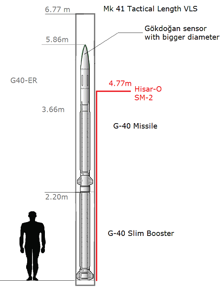

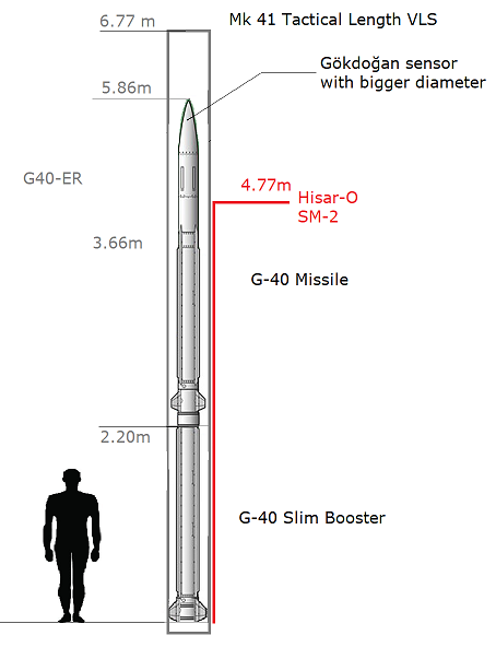

G40-ER dimensions compared with tactical length Mk 41 VLS if the rocket motor inside the missile or a similar length motor is used as a booster. I don't expect this kind of experiment with close fitting until booster tech and two stage is mature enough for us though. There are small errors and width is not considered for VLS cell, but gives an idea.
Edit: Fixed graphical errors and booster length. I left some space on the bottom of VLS cell for cables :) so the SM-2/Hisar-O also starts after the gap.

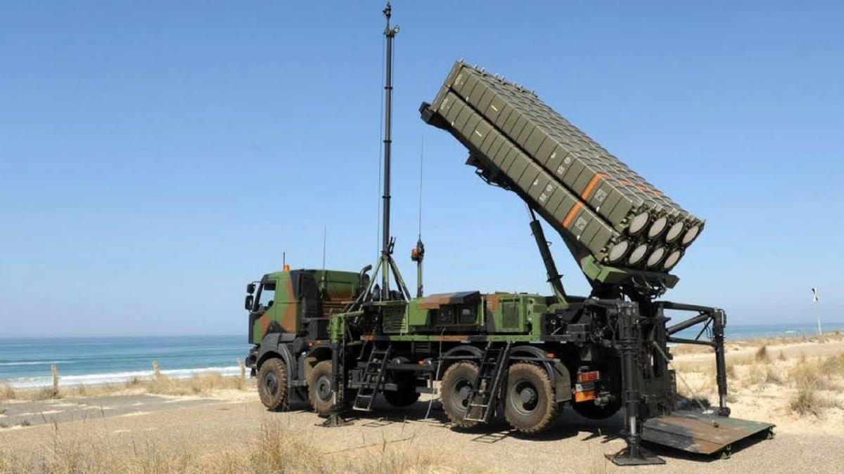

Signing of preliminary definition process has been completed on SAMP -T project. As there are no political bottlenecks the procedure is ongoing, final stage of which is to build an air defence system by the participant partners.
İ appreciate your afford, your drawing a great job but why don't we go for SM-2 fuselage which is larger, so that it'd give more range. Nonetheless larger seeker space could enable to use simpler sensors.
How many km range could g40- ER version intercept? App 70-80km while larger SM-2 equivalent could reach likely 150km. Moreover in future we could transform larger structure into SM-6 and SM-3 variants. I dunno Americans know their shit better.
