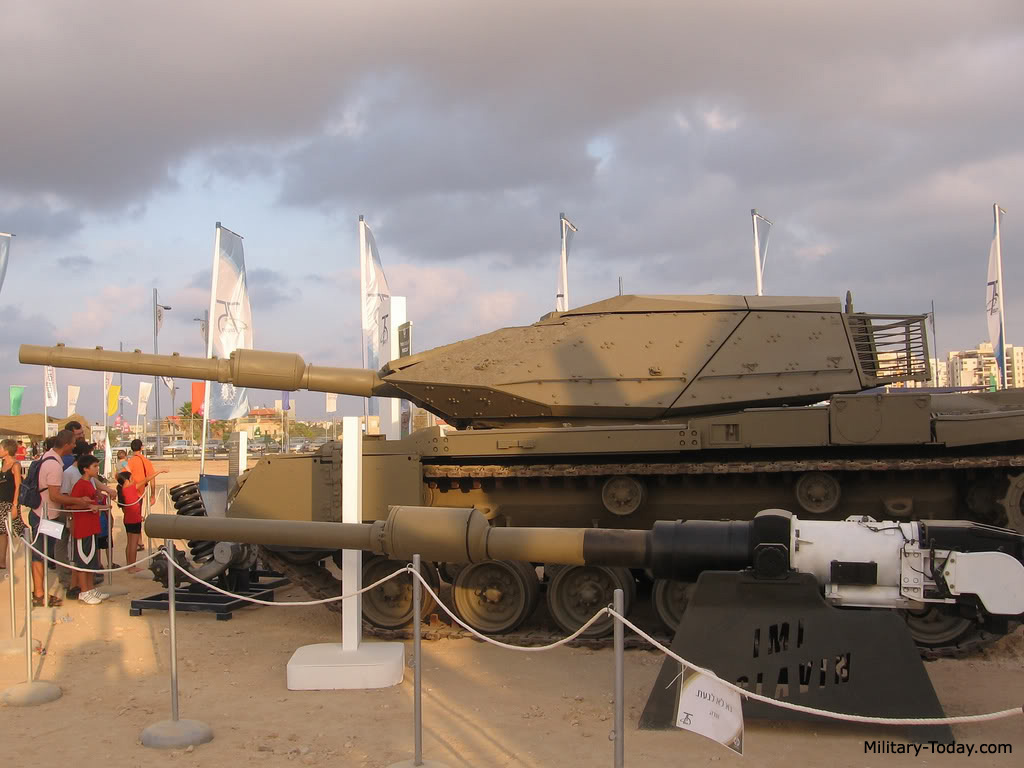

Yes, I meant the rest of the M60 versions in TSK inventory which were not upgraded through Sabra program.
As I've just said, probably because Land Forces Command wants to stick with 105mm. MZK could be fitted 120mm as it support 125mm but the MZK prototype we've seen was fitted with 105mm.
Sabra Mk I versions still uses the 105 mm afaik.
Turkish Armed Forces does not operate Sabra Mk.I, only Mk.II under M60T designation. That being said, Sabra Mk.I is also fitted with 120mm cannon not 105mm. You can compare Mk.I's cannon and Mk.II
