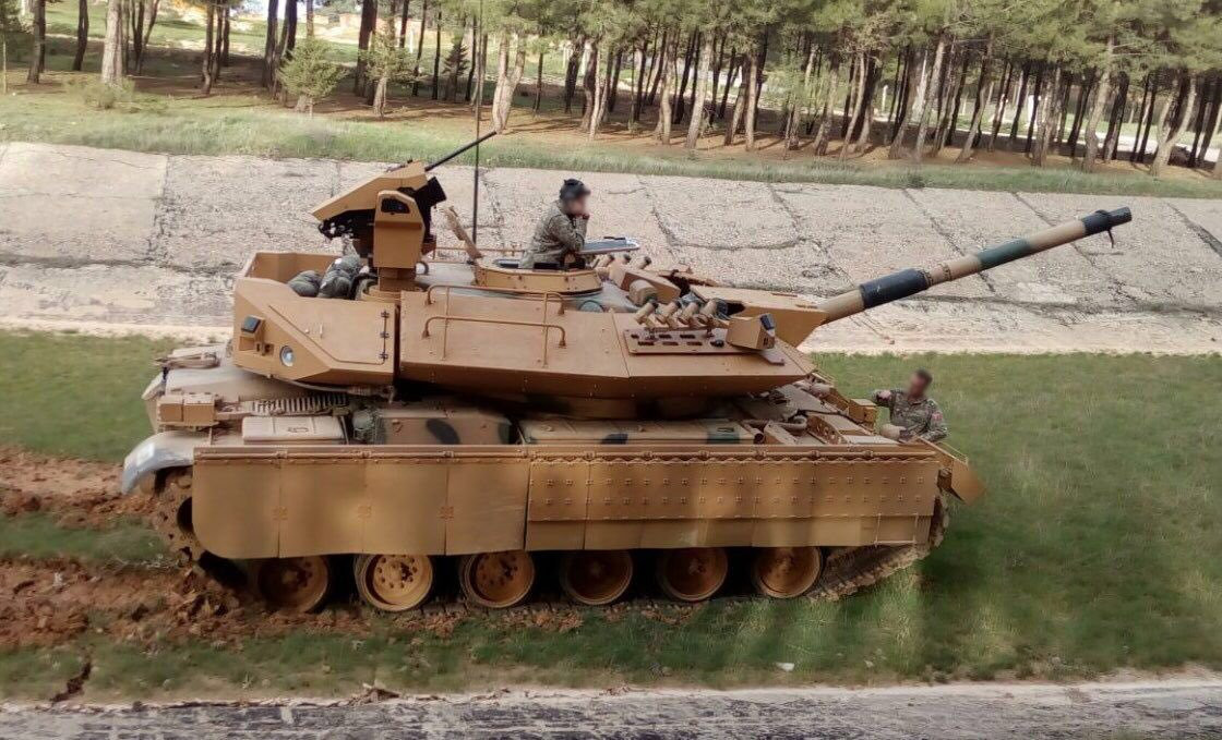

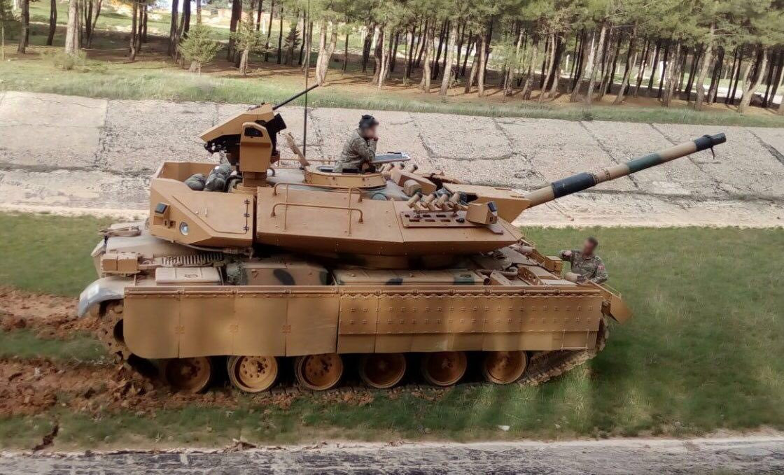

Am I the only one who cannot spot any difference in armor scheme ? It is also mentioned that it received side skirt armor too but it looks identical to both M60T and M60TM.
For the reference M60T
And M60TM
New designation M60T1 is also interesting, note that after Fırat Modernisation M60T were designated as M60TM.
Though it is similar to how M48 modernisations were designated (M48A5T1 & M48A5T2), but why M was dropped kinda puzzled me.

There was a similar attempt back then, it was not exactly "Sabra" but it was visually similar to it. Sabra proved itself on the field, I believe such modernisation would also fare well if it was not power pack screaming I'm dying.
Said Modernisation, M60A3T1
There are two problems I see with this configuration. The first one is that 105mm is an outdated cannon for a MBT nowadays. This problem can easily be solved by integrating 120mm cannon in the newly designed turret as we are already making them for Altay. The second problem is that most probably the weight of the tank will increase and more powerful engine will be required. I think there are some options, but most probably the TSK would want a national solution for this and they are right.
We should not count our M60A3 (and their potential modernisations) as fully fledged main battle tanks. Our armed forces has been using M60A3s as heavy direct close fire support vehicles for quite sometime. Since this direct close fire support practice is embedded in army's doctrine, I don't think we can get rid of M60A3s or similar vehicles in any time soon.
That being said, M60A3 modernisation having 105mm cannon is absolutely fine as their main job would be destroying entrenched enemy positions more then engaging armor. Also as far as I'm concerned, MKE does not produce any kinetic rounds for 105mm at the moment, MKE had license produce FP105 in 1980s though it seems they did not come up with anything local. This would be kind of disheartening as having at least few sabot in the rack would be nice in case of anything more than a Toyota shows up.
