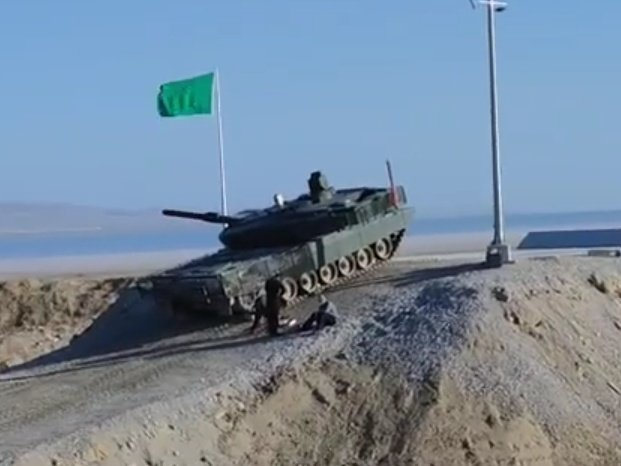

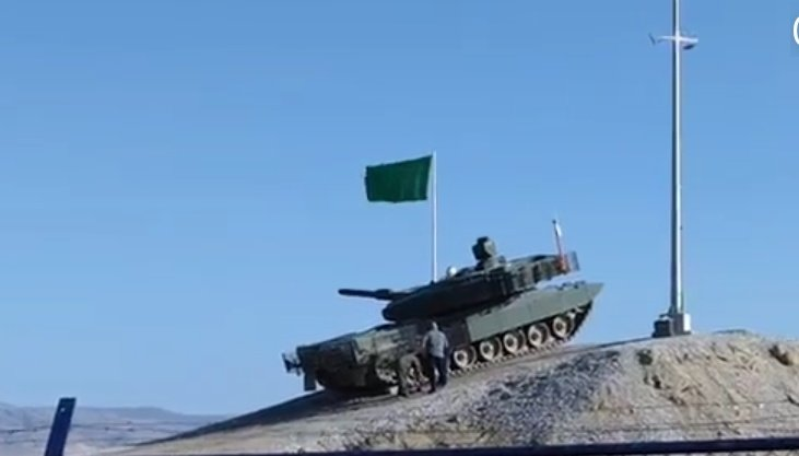

Leopard 2 NG being tested by ASELSAN
"It seems that Aselsan is testing a new fire control system on the Leopard 2NG platform. The driver's periscope looks different."
