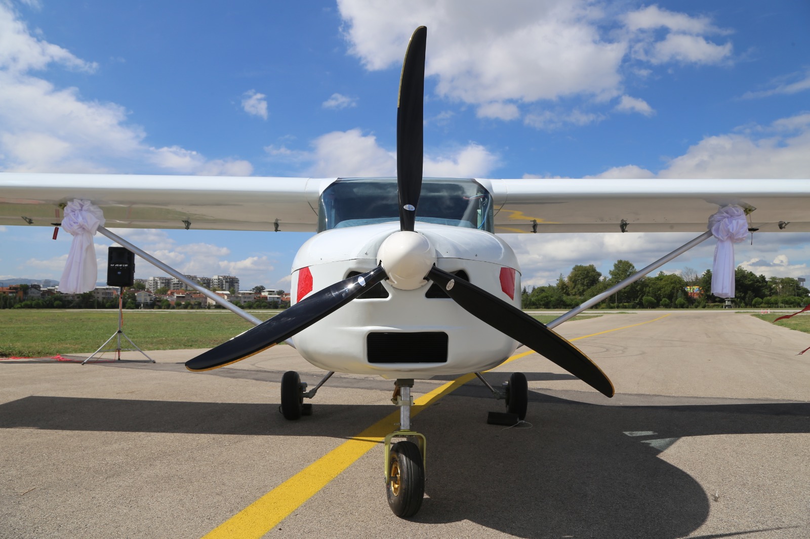

Uçaksan's first plane that was introduced last week seems to use the same 3 blade carbon fiber propeller.
