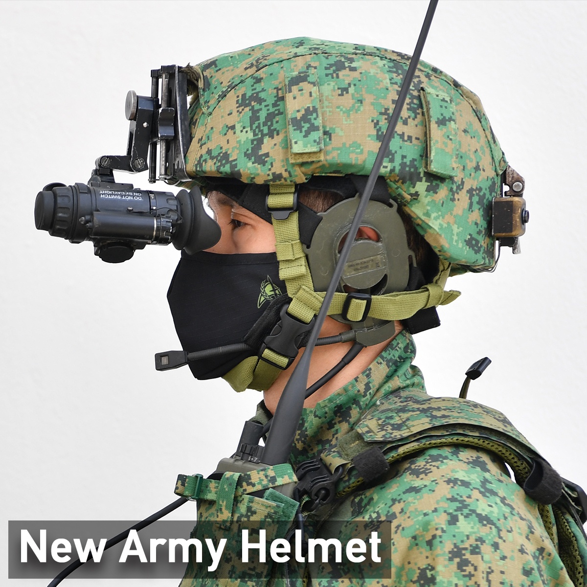

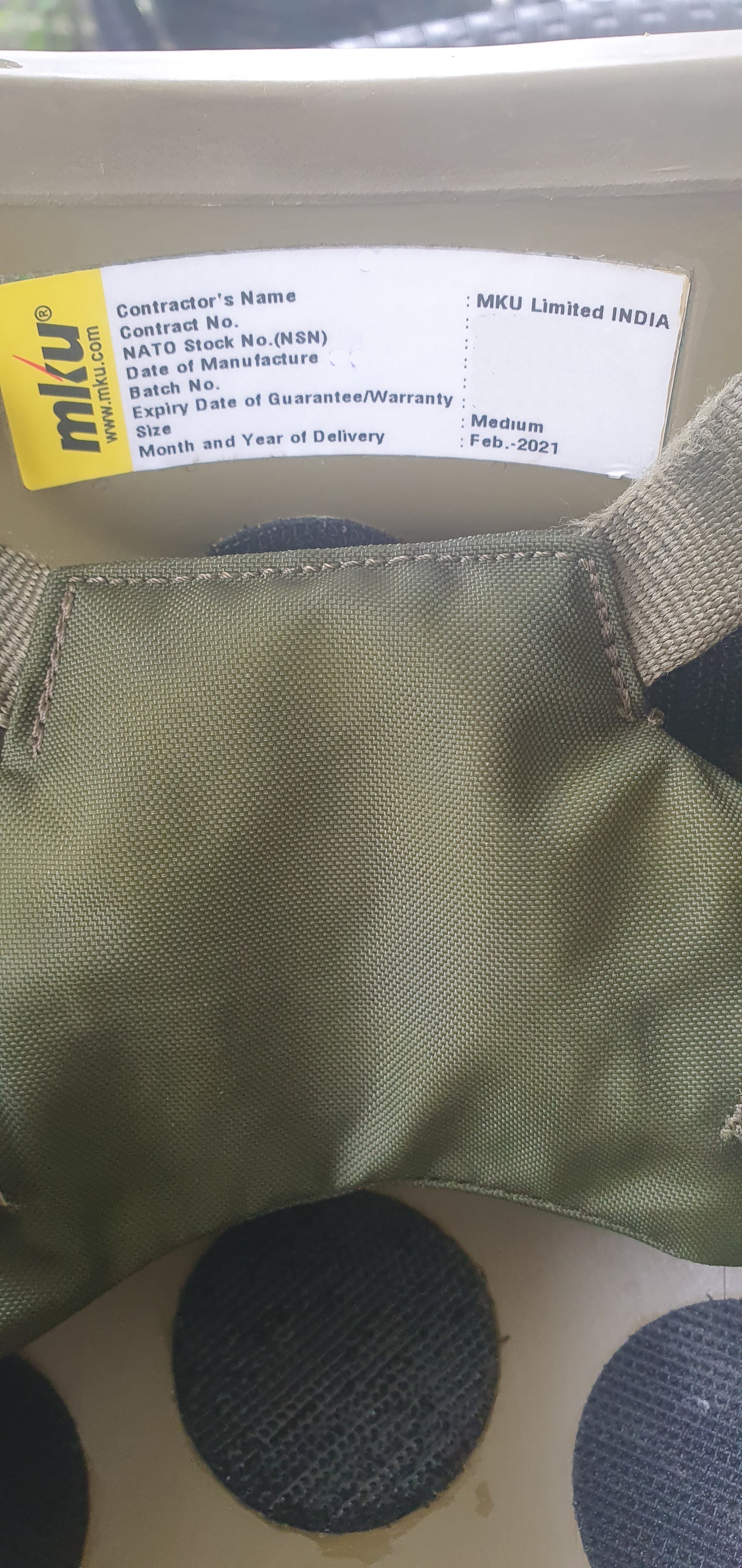

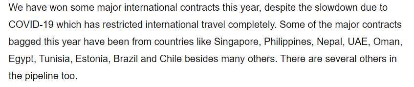

India's MKU seems to be the supplier for the new high-cut combat helmets of the Singapore Army, replacing their old PASGT-pattern ones. Same company supplies ACH-pattern helmets for the Indian Army, among other recent customers (3rd pic). It's unclear if Singapore army's Load-Bearing System (LBS) introduced alongside the new helmet is also from the same company.
