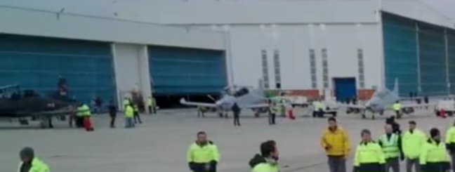

Three HÜRKUŞ can be seen in the HÜRJET video, two of them are for Niger 🇳🇪
