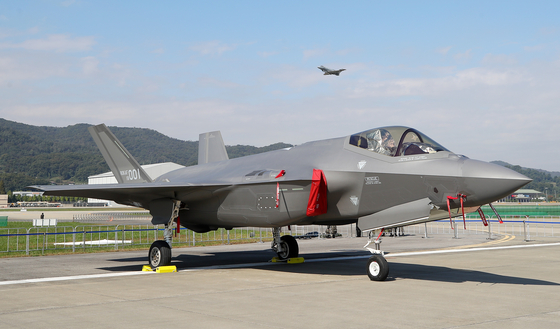

The landing gear of the South Korean F-35 was hit by a bird, and the aircraft was retired, since the cost of repairs was more than the aircraft.
But what would happen if the bird hit the outer fuselage part designed to protect pilots?
Here are the high-speed bird impact tests of the Hürjet, Hürkuş and F-35
Nothing different than what might happen if the same thing happened to any other plane. Most of the damage on that Korean F-35 wasn't caused by the bird, it was caused by the fact that the pilot had to land the plane on its body instead of the landing gear.

It was most probably taken out of the inventory due to damage received by the belly landing the pilot did.

The belly landing was a result of the severe damages on F-35A due to an "eagle strike" mid-flight.
Shit happens, from 40 down to 39 stealth fighters. Possible deal for 25 more F-35As in the pipeline.
The F-35A on Jan. 4 ran into an eagle at an altitude of roughly 330 meters (1,082 feet), not long after taking off from the Cheongju Air Base in North Chungcheong.
The eagle was sucked into the fighter jet’s left air intake, damaging the hydraulic duct and power supply wiring that are essential to the navigation system and landing gear operation.
The aircraft had to make an emergency belly landing at the Seosan Air Base in South Chungcheong.
A joint inspection on the fighter jet with the manufacturer Lockheed Martin found 300 areas of damage, including in the engine and navigation system.
The fighter jet will be retired once the Joint Chief of Staff and the Defense Ministry give the final approval.
However, the Korean Air Force said the retired fighter jet could later be put to use in maintenance training.
Thanks for this. Turkish twitter "media" is hell, they managed to get every detail wrong.
I don't understand how a bird entering the air intake can damage hydraulics and wiring. Perhaps they are located behind the S-bend and the mass of the bird was too high for it to resist?
That's like saying "he didn't die because he was shot, he died because he didn't have enough blood". Is every other jet's landing gear so weak that a bird can break it? I doubt it.
The explanation for the belly landing was not connected with the bird hitting the landing gear, according to what is written above. Mind you, if a bird is ingested into an air intake I would expect damage to be limited to the engine unless it failed catastrophically. But I'm not a designer or engineer.
Thanks for the correction. Most aircraft are indeed tested to withstand a bird strike into an engine. In the FAA certification standard it explicitly says this includes the inlets, so the F-35 design is flawed in that regard.

According to other reports it was a 10kg Far Eastern sea eagle with 2m wingspan. A very fat bird so to speak 😁
F-35 has DSI air ducts which may have diverted the impacting bird to other important airframe parts before reaching the „cutting“ turbine blades and the fighter body is packed to the brim with electronics & hydraulics.
