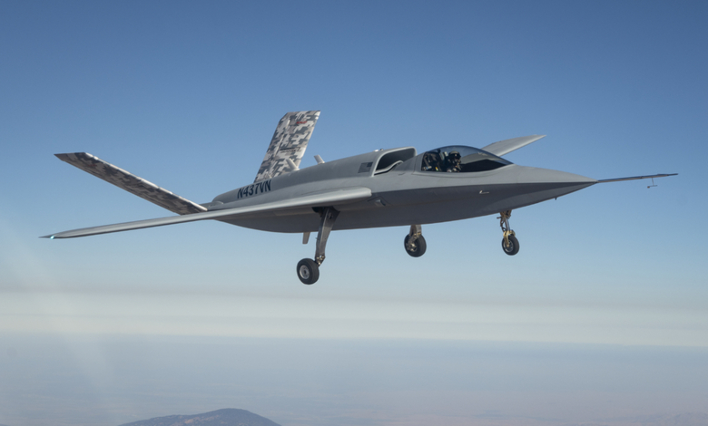

Manned unmanned aircraft
somegoodusername
225
2 378
Adding a pilot seat for purpose of conducting tests for the unmanned aircraft is not something new.
2,973
62 5,311
So Transforming UAV into manned appears not a big trouble which increases cost, design, etc.
Easy job
boredaf
2,306
42 6,770
Easy job
No it isn't, if you are trying to make an actual fighter out of a drone that is not going to endanger a pilot during a flight/war. Not to mention this thing has 1000 kgs of payload capacity, why would you want to risk a pilot when we already have two drones in work that can carry more?
