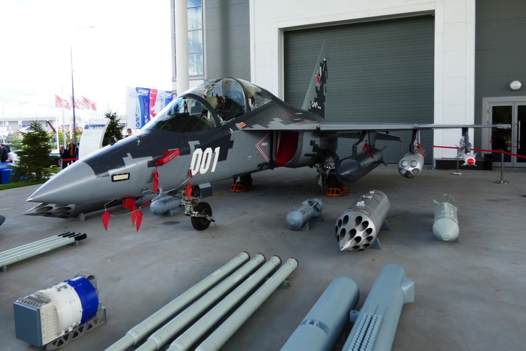

So.. I-22 Sikatan was not a dumb idea at all. :)

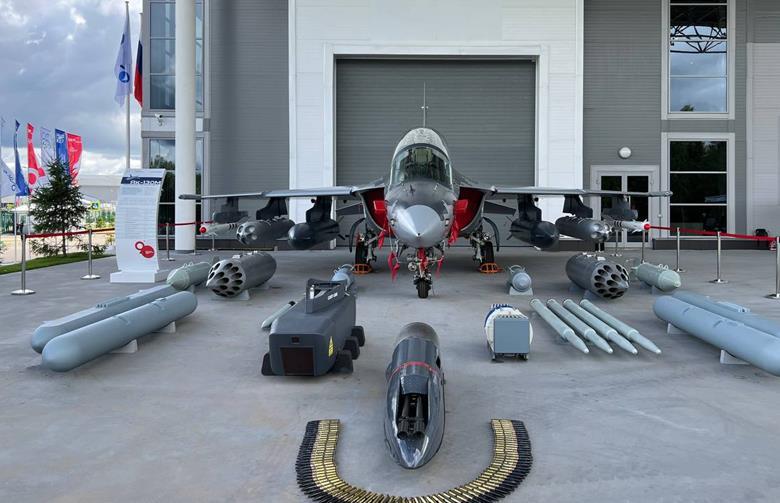

I didn't know about Sikatan, i thought you were swearing to me😅 Sikatan appears to be a real:)
Minijet fighter Sikatan is exactly what we need💪🏻
