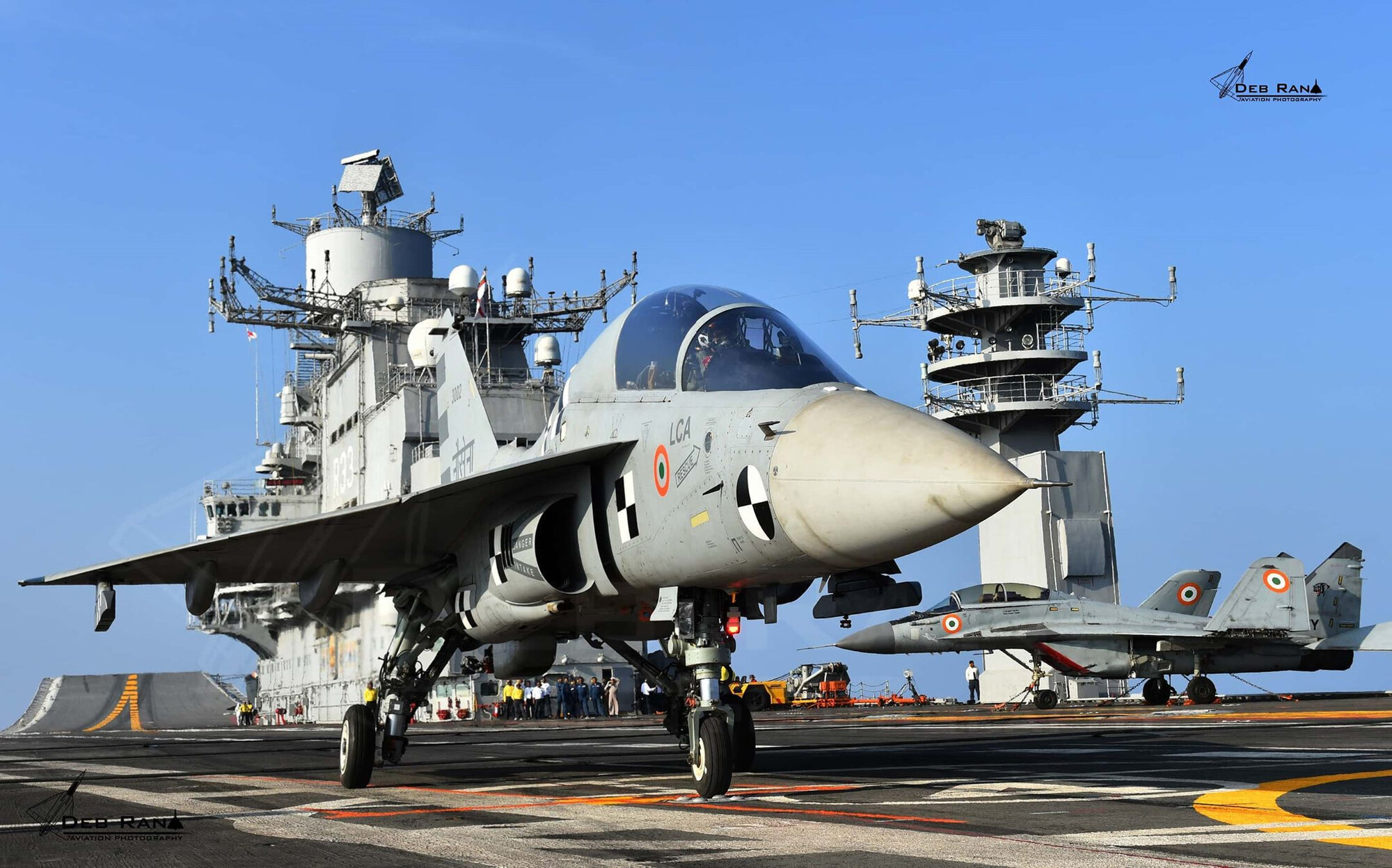

Sounds great, the only concern is if it can take off from a shorter deck. TCG Anadolu is about 230 meters long.
Considerably shorter than the indian aircraft carrier.
It will be hard to take off at that length unless the deck is fitted with EMALS
I'm thinking not...but even if it could, the payload penalty would be too much.
Any other fighter is also likely to face the same problem but some improvement could be noticed if the weight of the aircraft itself were to be considerably lesser (like at least 3-4 tons lighter).

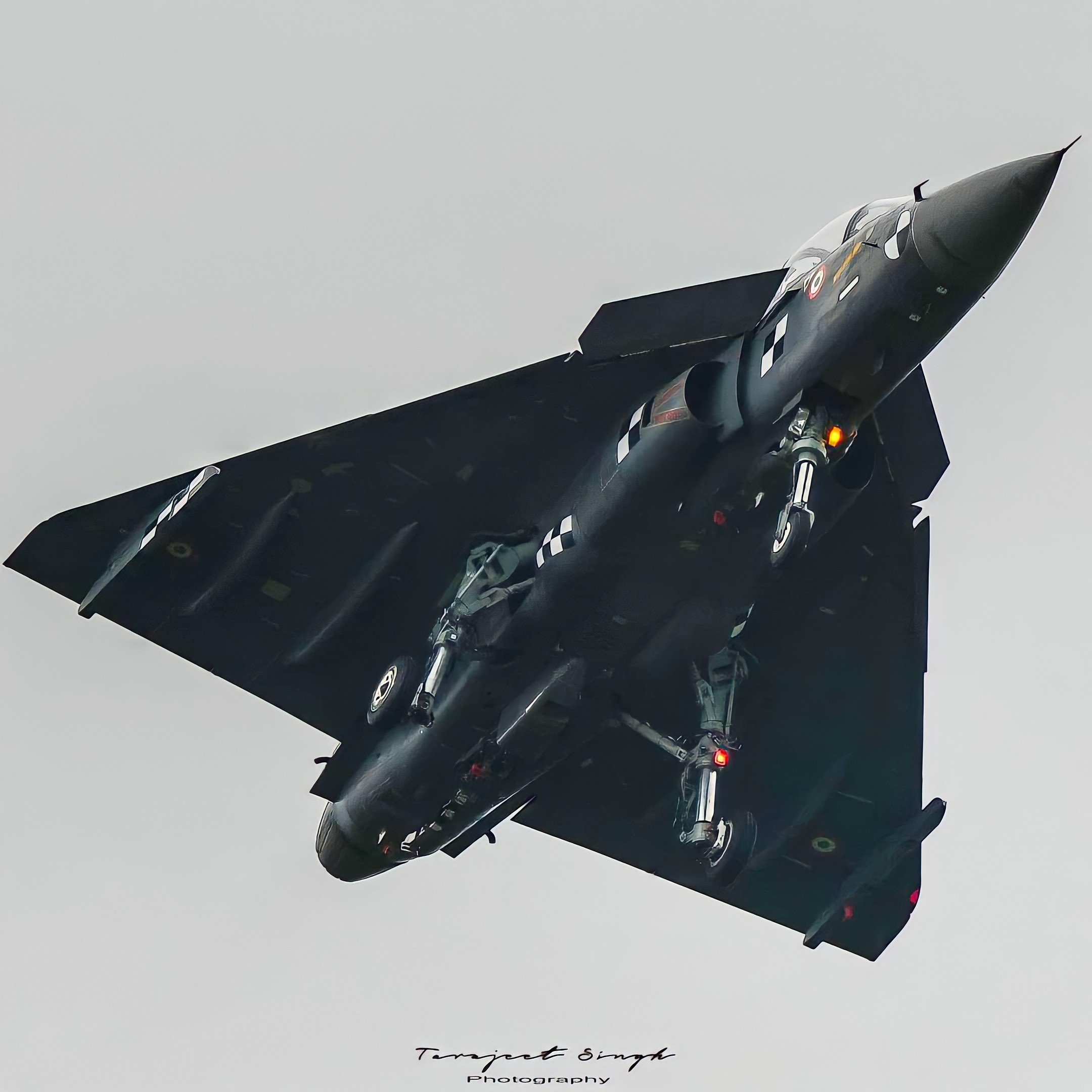

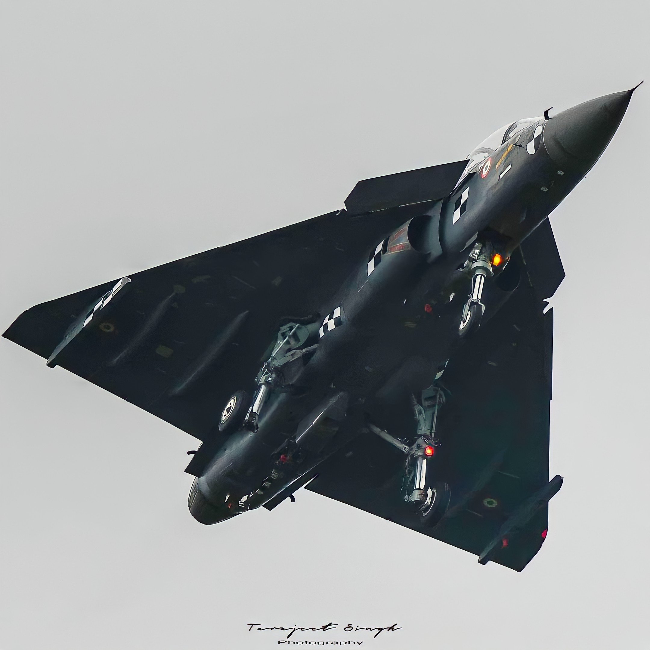

Some of the best shots in my collection of the NLCA NP-2 (single-seat prototype):
Actually aircraft don't takeoff from full length , it take off from shorter predefined run way .
If full length of tcg tarkaya is used it can very well takeoff and land .
But that increase issue like space for other jet to be in standby etc .
Emals if used can solve the issue .
But imo , any jet without high twr like f 22 won't be suitable for takeoff and landing on such small stripe without a risk

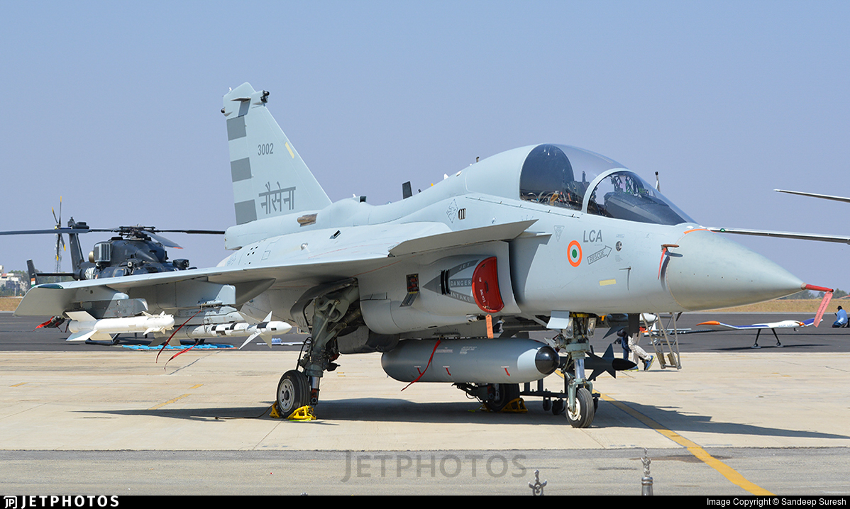

Last month, HAL had placed a $716 million order for 99 x F404-GE-IN20 afterburning turbofan engines from General Electric of US. This order goes toward fulfilling the $6 billion contract HAL received from the IAF earlier this year for 83 Tejas Mk-1A multirole fighters. The "IN20" is the highest-thrust variant of the F404 engine family and comes with FADEC. Engines of a similar configuration were already contracted previously to power the 40 jets of the Mk-1 standard ordered so far (and most of which delivered). The 99 new engines will go toward powering 73 single-seat Mk-1As, 10 twin-seat trainer variants plus 16 spares.
The two sides also planned to produce the higher-thrust class F414 engine in India, which is earmarked for the Tejas Mk-2, twin-engine TEDBF as well as next-gen AMCA fighter programs.

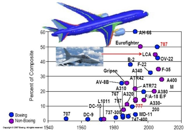

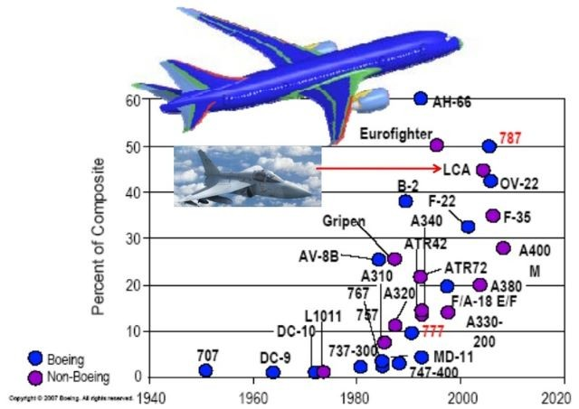

The composite materials content on the LCA is extremely high among fighter aircraft - surpassed only by the EF Typhoon.
From a Boeing publication:
Zapper
India Correspondent
1,830
11 1,125
No wonder it's fairly on the expensive end along with an American engine and certain Israeli sub-systems. Now that we've already developed, integrated and tested indigenous versions of the avionics & EW suite, Uttam AESA radar and certain other sub-systems which are most likely to be assembled in Mk-2...it should definitely help controlling the costs
