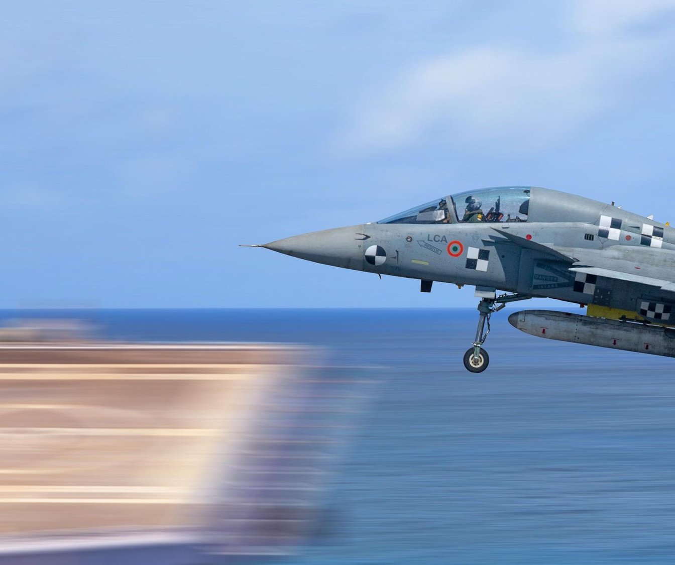

NP1 - the first Naval prototype (twin-seater)

Since there's no naval aviation thread I'm posting here...
...the exact moment before an NLCA touches down on the INS Vikramaditya
Single-seater variant seems to have worse visibility. It looks like the pilot would have a hard time seeing what's behind him. Not ideal.
Twin-seater variant looks better.
