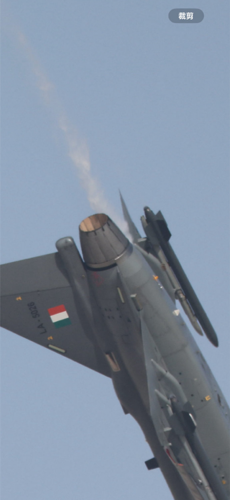

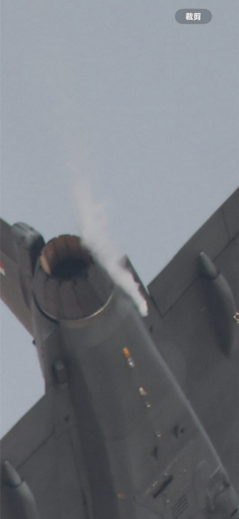

Aircraft can leak oil, I vividly remember the US aggressor F-18s leaking oil on the ramp like drunkards. Some say that was not oil but water instead, also possible.
Regardless, it's an active duty aircraft of the air force without known issues. Tejas is many things, but it doesn't just lock up and crash. This looks like a very clear case of pilot error to me.
Was the APU smoking? Or was that smoke for the show?
APU exhaust should be up top. Smoke generators are on the wing pylons as fake missiles. Interesting.
Of course aircraft leaks oil. But there are limits for that, depending on engine. I remember maintanence guy counted the drops, if it is (lets say) under 15 drops a minute while the engine running idle, the aircraft is good to go for (lets say again) 2 hours of flight and inspect further after that, over 15 drops no go.
It can not be water btw. If it was there was no can to collect. Because while water is harmless, oil is however, clear FOD (Foreign Object Damage) and can be very harmful even dangerous when sucked into engines. So leaked oil has to be removed and cleaned from the apron. In civil airports, airlines have to call the airport authority when leaked on the ground and pay for the oil cleaning service, if you dont there is severe penalty for leaving oil build up. For the military airports (in our AF case), there are always airport maintenance crew to take care of such FODs.
