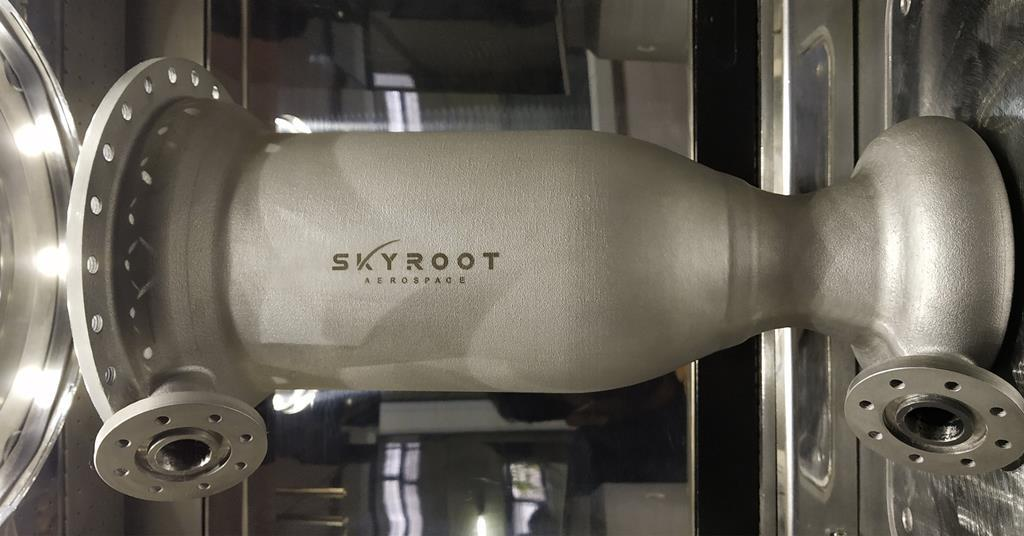

OTOH, Skyroot Aerospace managed to test their 100% 3D printed regeneratively cooled LNG-LOX cryogenic engine called "Dhawan-1" in September 2020.
We don't have the thrust figures yet but this can probably generate no more than 30 kN. So not as powerful as ISRO's engine but still a pretty good effort.
Did they actually test it? IIRC, they just unveiled it - all the testing so far concerned only the solid motors & the only liquid one to be tested was the orbit-adjustment motors.
They said so on their twitter page. Strange their twitter page is down. Can you access it ?

As for skyroot et al:
It indeed is a great effort as the key thing here is production turnaround. If engines can reliably be printed, that saves immense amount of manhours and associated costs.
What thrust you do manage to get is somewhat secondary to that as this is gamechanger for lot of light payload missions...that takes the burden off the resource-heavy rockets which can then focus on heavier set piece payloads.
