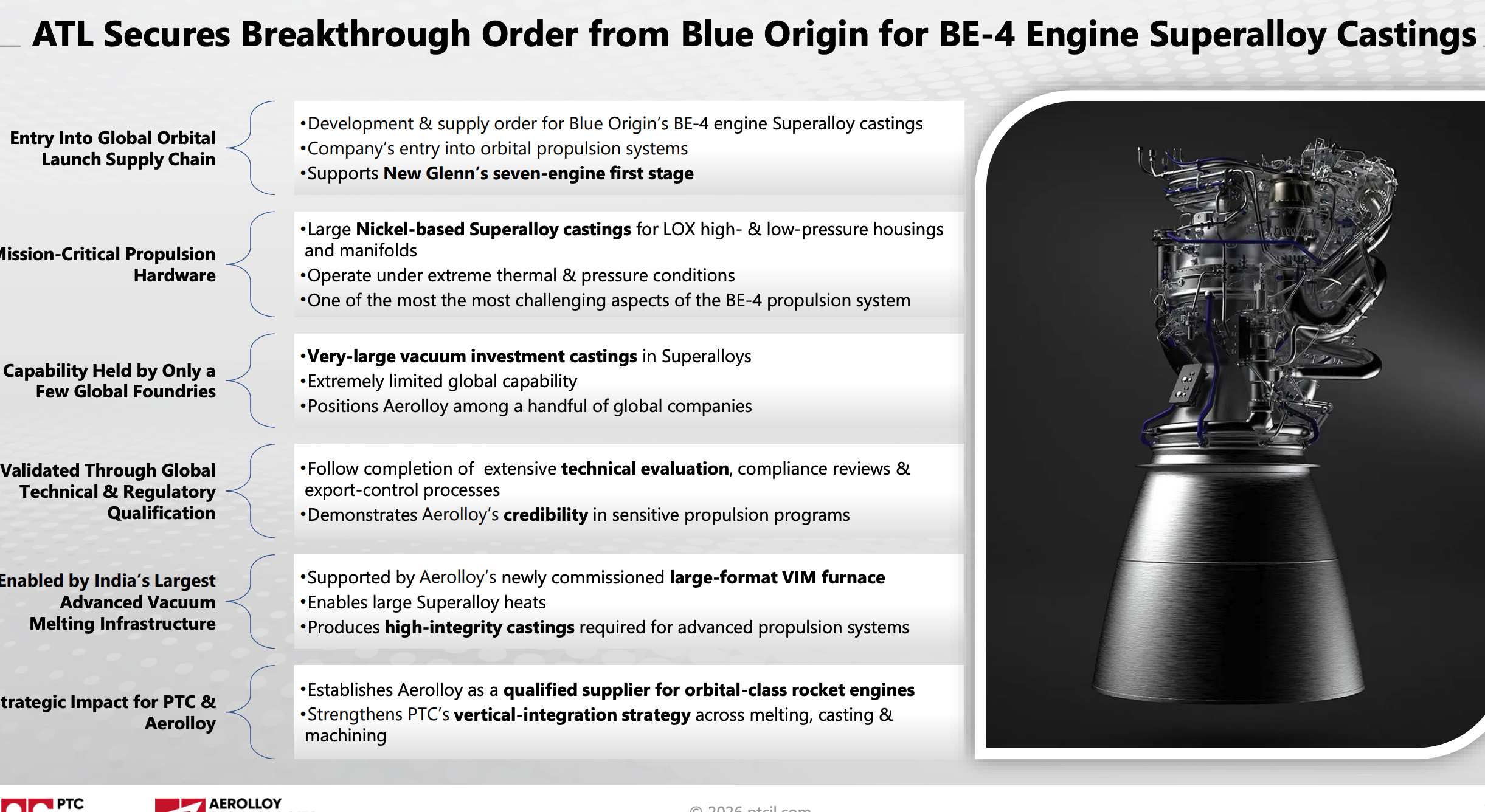

Not related to ISRO. PTC Industries capabilites are crucial for NGLV Methalox Engines.
More info:
I've had my eye on PTC and its subsidiaries for a while, it's not an exaggeration to say they have among the most important private-sector strategic engineering capabilities in the whole country, right alongside likes of L&T. These guys are serious business.

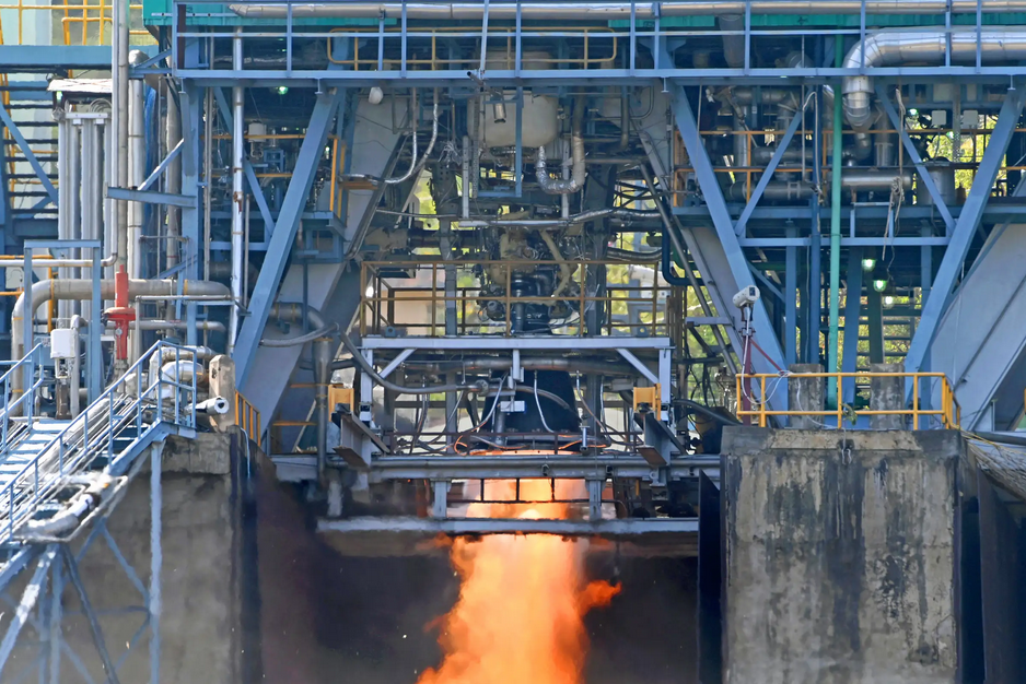

https://www.isro.gov.in/ISRO_conducts_sea_level.html
ISRO conducts sea level test of cryogenic engine at 22 tonne thrust level with full area nozzle​
March 12, 2026
ISRO successfully conducted a sea level hot test of its Cryogenic engine (CE20) at 22 tonne thrust using nozzle protection system and multi-element igniter, on March 10, 2026 at ISRO Propulsion Complex, Mahendragiri. Earlier, the sea level tests utilizing nozzle protection system was being carried out at 19 tonne thrust level.
The CE20 cryogenic engine powers the upper cryogenic stage of LVM3 launch vehicle. In order to enhance the payload capability of the LVM3 vehicle, future missions of LVM3 are planned to be operated with an uprated C32 stage with 22 tonne thrust for the CE20 engine. In view of this, the flight acceptance test of the CE20 engine also needs to be conducted at 22 tonne thrust level. Therefore, the present test qualified the sea level testing of the engine with a test duration of 165 seconds at 22t thrust level using the Nozzle Protection System (NPS). The performance of the engine as well as the test facility was as expected during the entire test duration.
Testing the CE20 engine at sea-level possess considerable challenges primarily due to high area ratio nozzle, which has an exit pressure of ~50 mbar. Main concern during testing at sea-level include flow separation inside the nozzle, which leads to severe vibrations & thermal problems at the flow separation plane leading to possible mechanical damage of the nozzle.
The Cryogenic engine utilized for this test has undergone a record maximum number of hot tests (20 No.s) successfully, that has enabled the demonstration of several key technologies using a single engine such as engine ignition using multi element igniter, ignition margin demonstration for Gaganyaan over a wide range of propellants tank pressure and pre-ignition chamber pressure, engine qualification for Gaganyaan at 20 tonne thrust level, demonstration & qualification of 22tonne thrust level operation, boot-strap mode starting of CE20 engine without start-up system for enabling re-start in flight, indigenous turbopumps bearings qualification, indigenous sensor qualification and Nozzle Protection System qualification for high area ratio nozzle hot test at sea level.

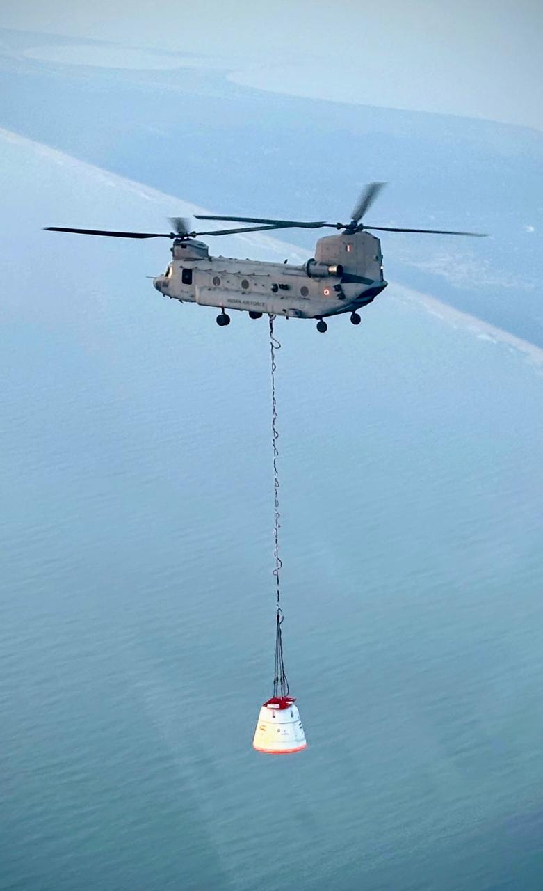

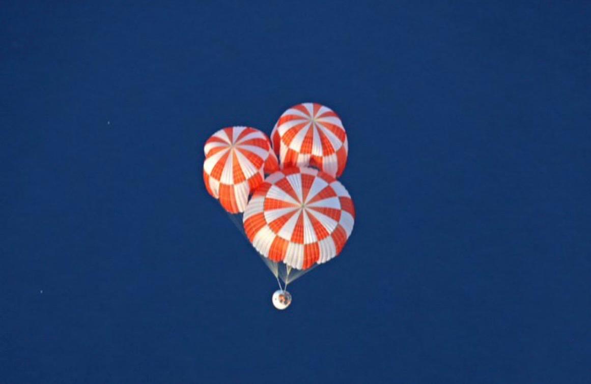

ISRO conducts Second Integrated Air Drop Test (IADT-02) for Gaganyaan
April 10, 2026
The second Integrated Air Drop Test (IADT-02) for Gaganyaan mission was successfully conducted at Satish Dhawan Space Centre, Sriharikota on April 10, 2026. In this test, a simulated Crew Module, weighing about 5.7 tonnes, that is equivalent to the mass of the Crew Module in the first uncrewed Gaganyaan mission (G1), was lifted by an Indian Air Force Chinook helicopter to an altitude of about 3km and released over a designated drop zone in sea, near to Sriharikota coast.
Ten parachutes of four types were deployed in a precise sequence during the descent of the Crew Module, gradually reducing the velocity for safe touchdown. Subsequently, the simulated Crew Module was successfully recovered in coordination with Indian Navy. The IADT-02 test validated the parachute-based deceleration systems in the Crew Module.
This test marks another significant step towards the readiness for the Gaganyaan G1 Mission, with active support and participation from the Indian Air Force, Indian Navy, and Defence Research & Development Organisation (DRDO).
