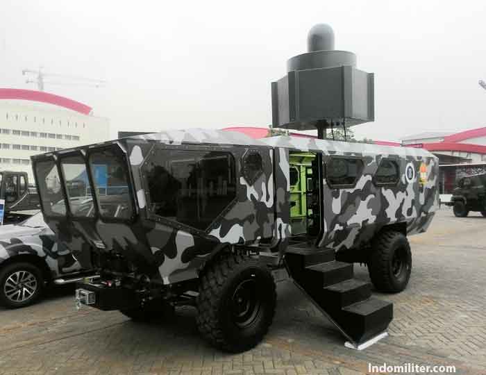

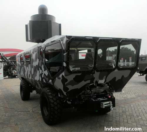

Qatar
It could be a passive radar, like that was made by ITB. The radome and the vehicle is different though.
There is another radar made by Balitbang and PT RTI, it is for air defense
It looks good by all means

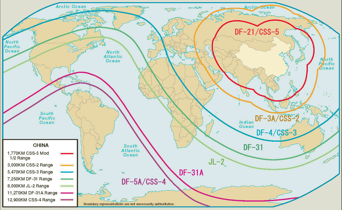

0:50 : "Selain itu [...] masih dalam jangkauan peluru kendali antar benua negara tertentu..." ([The new capital] is still in the range of intercontinental missile fielded by a certain country).
So is Jakarta.
If we're talking about getting out of range of Chinese ICBMs, how about moving the capital to South America or to some part of Antarctic instead?
smh... :rolleyes:
