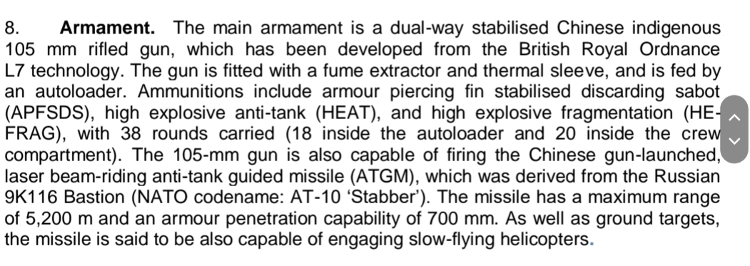

kaplan itself had 16 ready to fire round on turret bustle with the rest of 28 munition are stored in the hull between driver and crew compartment.
are there any bangladesh review on the VT-5 interior since they were the first foreign user ?
7,116
10 6,130

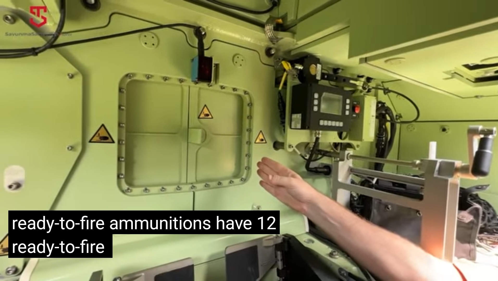

interesting, do the Cockerill 3105 have another customizable config since their specshet mention 12-16 rounds ready to fire.
I hope the buy 16 round version for the next batch. Lesser rounds stored in the hull the better.

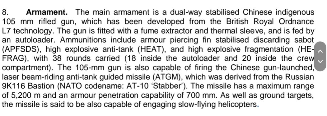

@Umigami @R4duga you are absolutely right, there is no way 38 round would be ready to fire.
i was just messing around.🙃Iirc, somewhere it was mentioned to be 22. but it was probably for Chinese Type15, I cant confirm it for VT 5.

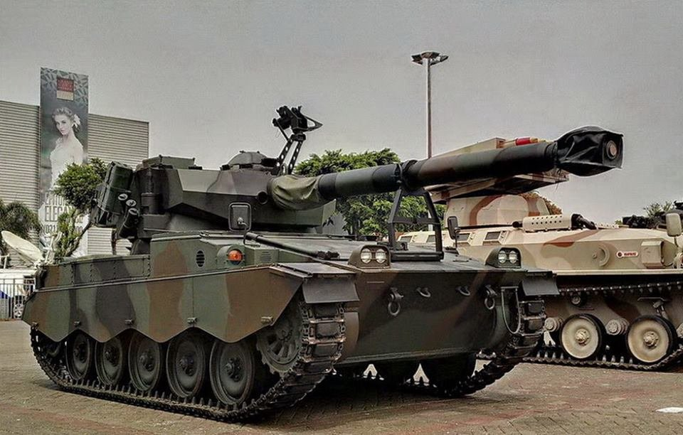

Our 105HP cockerill gun isn't L7 derivative?
deadlast
158
2 364

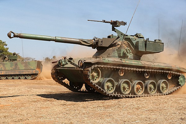

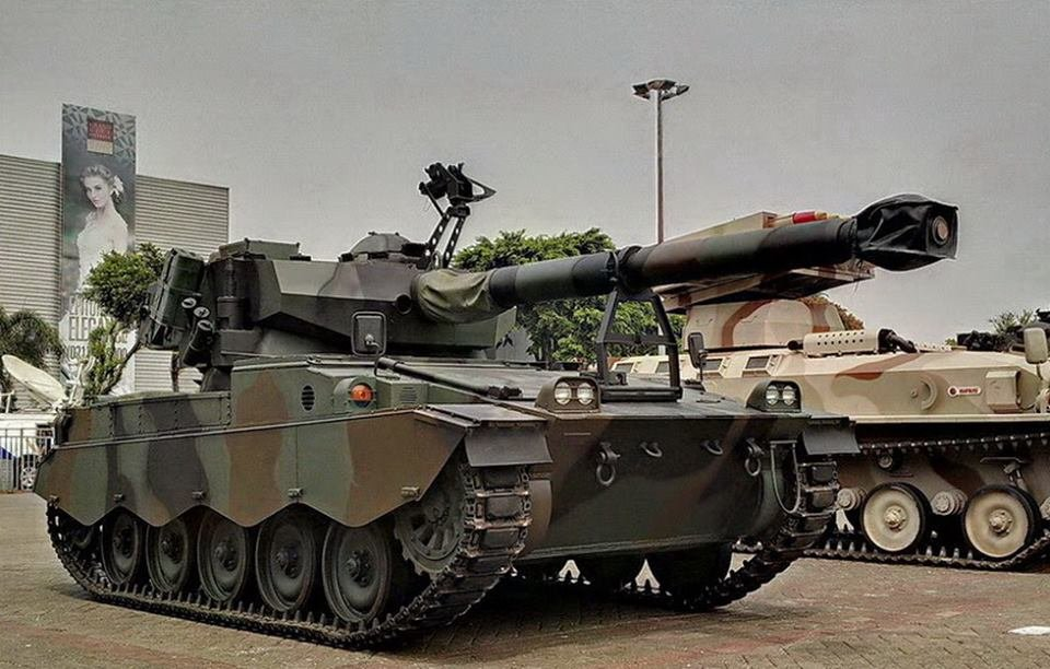

So AMX and Harimau has the same gun?
I don't think so.
Their 105 ammunition are different

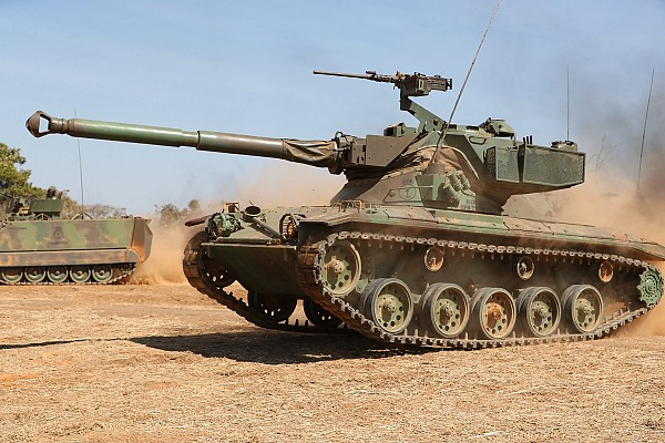

AMX-13/105 FL12 has the GIAT CN-105-57 firing HEAT (Officially; there are aftermarket APFS-DS being offered IINM)
Note the "bow tie"-shape double baffle muzzle break on GIAT CN-105-57.
AMX-13/105 FL12 upgrade (gun swapped) has the GIAT CN-105-G1 firing APFS-DS
Note the FL-12 turret with the round-shape muzzle brake of GIAT CN-105-G1 on the first and second AMX, the third (rear) are still in it's original GIAT CN-105-57.
AMX-13/105 Retrofit has the same GIAT CN-105-G1 firing APFS-DS
Round-shape muzzle brake of GIAT CN-105-G1.
Harimau use Cockerill 105mm
Note the different profile of the muzzle brake, fume extractor and the presence of thermal jacket on the barrel.
Tl;dr, Harimau does not use the same guns as AMX-13, AMX-13/105 has French proprietary 105×528mmR caliber, the L7&Cockerill 105 has NATO standard 105×617mmR caliber.
