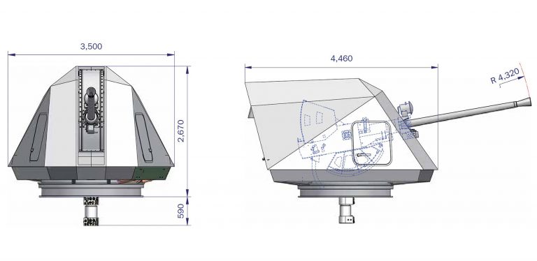

The BAE/Bofors 57mm Mk.110 is a significantly larger gun system but retains some key advantages over larger 76 and 127mm systems. Its non-deck penetrating.

I said some key advantages over the larger one. I am not saying compared all the thing apple to apple.
While this gun doesn't offer the range and lethality of the 127mm and 75mm guns, some of its performances are comparable to those. such as
1. the rate of fire and the amount of explosive per shell into account (the Bofors gun achieves a higher amount of "explosive fired per second" compared to the 76mm.
2. the 57mm shells being smaller, a greater number may be stored aboard the ship.
3. a smaller main gun because of its lighter weight could allow the installation of larger remote weapon stations.
4. it's adequate against air threats and it also has a CIWS function, with or without specialized ammo.
5. it's very good against numerous small threats (i.e., small boats) using the 76/120 for that is not wise decision.
6. Life cost

All i am telling, Indonesian Navy had reasons to chose 57mm on KCR, but it doesn't make it the perfect gun or the shell of a size with sweet spot compared to 76mm as you claim. (At this point mentioning of 127mm on FAC is pointless)
Check out Sa'ar 3, they could fit a 76mm gun. And my point here, if it was required the hull could handle it.
Just to be clear. My previous statment is stated about some advantage of the 57mm over the bigger gun. I am not saying 57m Is better in all aspects over the bigger gun. 76 mm and 120 it self have some disadvantage over the smaller one.
Lets me ask u, are u believe saar 3 not need to exposed her crew when reloaded the ammunition. Since, from the air draft only I can guess they dont have the enaugh space to keep more ammunition. Compared if we use 57 mm on our KCR by size,space and volume, we can double the quantity.
Please compare weight of 57mm and 76mm, you will see the surprise there. Bofors 57mm is not really a light weight and petite solution, its occupation and weight is in the same class with a 76mm (above deck). There are other reasons to choose this gun, like i have told before there should be a solid reason to not use the space below deck or avoid it.
Yes, but how about the amount of the ammunition that can we load and store. The weight of ammunition it self is far to different. 57mm per round is 6.5 kg and the 76 mm round is 20kg.
How about the weight of the gun. ok, 57mm is 14 ton and 76mm is 21 ton.
Another's advantage is the fire control radar and optoelectrical fire control system such like thales mirrodor system and we have cooperation with thales indeed.
And for the last,57mm was probably chosen for the tradition, past experience, personnel knows how to use the caliber and acquainted with cannon itself more than the 76mm (I know 76mm is also in use, but 57mm seems to have more prolonged application) just as you have said.
Also to be honest it is easier to include it in the design compared to a 76mm super rapid, less complex (doesnt require an accessible below the deck room, smaller deck opening, foundation and hull integration is less complicated etc) and great option to start with a design.
This what i've tell you since the beginning + plus some advantage that I mentioned above, isn't?
Please look schematics of oto melara 76mm and you will see how its reloading and feed mechanism works for decades. It doesn't occupy that big space below the deck too.
Turkish Navy kilic class ,which is nearly 8.5 meters wide and with draft of 2.8 meters , operates 76mm as well, i have a friend on there, they are quite comfortable with it.
Space wise 76mm munition only occupies 30% more space just because of its length. Volume= weight. A ton of difference isn't really a big deal for ship of that size too.
You must be joking to compare manned gun with rifle.
Indeed, 57 rate of fire is 220/minute while the 76 is only 80/ minute. This itself is important when you facing fast small boat threat to sustainable continuous fire in order
Fast forty or twin forty is much better in this case then, this is what i mean you can't compare these guns on the same basis. Twin forty delivers smaller munition but in much higher rate with double, backed up barrels.
(2x300 for base model, 2x400 for fast model)
And while engaging fast targets, fire control system matters more than the rate of fire. 76mm can handle fast moving targets pretty cool with a good fire control system.
Again if this boat meant to counter anti symmetric threats (land/air) twin forty with programmable munition would be a better fit.
Similar type of rounds have similer weights in ratio of the explosives they have. 20 kg shell of 76mm is a variant which is not available on 57mm, HE- AP shells of 57 mm and 76mm are 6.5 and 12.5 kg respectively.
For example see here:
Dry weight of 76mm without ammo is 8 tons;
Plain 57mm is 7 tons,
With 1000 munitions 57mm results in 14 tonnes, 76mm results in 20 tons. Again this contradicts with your claim of 20 kg per shell for 76mm, a usual shell of 76mm is 12~ kg.
If handled during design stage 7 tons are simply nothing but a milimeter increase on the outer shell, for more firepower this can be done.
I agree on most parts, except those advantages written on paper was the driving point of chosing it.
76 mm dry wight it self is 7 ton.
Thats mean the gun, is not with the revolving magazine system.
20 kg per shell is TYPO things. I my trying to explain 28 pounds of the 76×636mmR. But instead conversions the pound first, I continued with the kg cause of typo thing.
