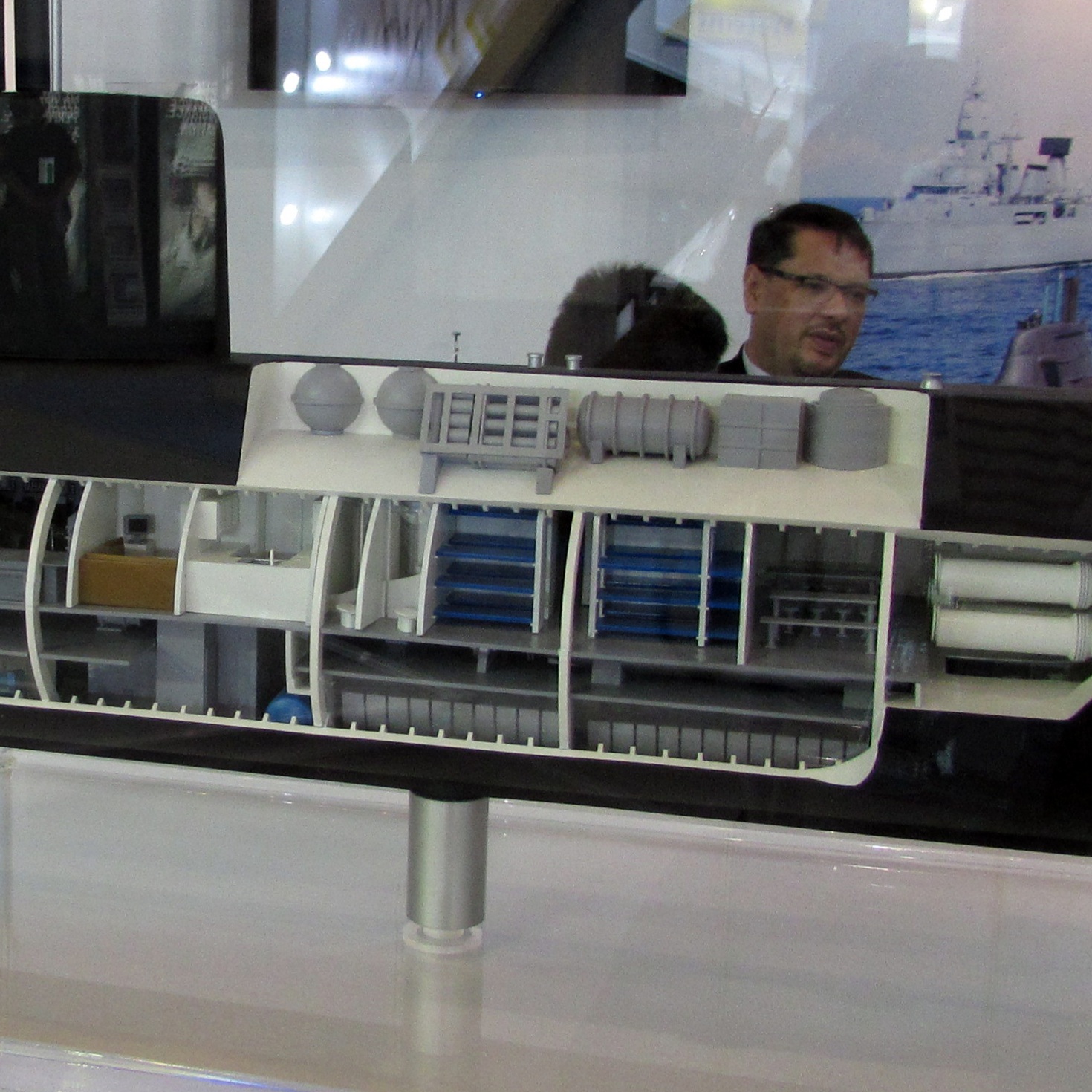

9. The Torpedo Room
On this type of submarine, torpedo room is the spacious room inside the hull, why? because it supposed to be become the Torpedo storage room, if you see on the part 1 cutaway pict, you could see torpedo there, but, i just realized that cutaway pict doesn't always accurate, since Type 209 series has so many here and there modification specs according to each navy. What you will see on the torpedo room is not a torpedo, but rather
a table
that is Brazilian Type 209 1400, and ours are the same
*what you see on the torpedo tubes is not a censor, it just a white table that being stored
Because the Crew Compartment is located right behind the Torpedo room without any divider or penyekat , so the Torpedo Room is becomes one with the Crew Compartment.
And here is the question, according to the specs, you may read on wikipedia and other source, Type 209 1400 can carry 14 Torpedoes, 8 inside the Torpedo Tubes, and 6 stored. AND you should also understand, that the average 533mm/21" Torpedo is 6 meter long and 1.5 Tons heavy
*some part deleted in later edit due to mistakes
And If you still wondering, there must be some room underneath the deck, yes they are, but not for storing munition, but for batteries
Also funfact, the submarine doesn't always carry the Torpedo in the Torpedo tubes all times, especially if there is peace time, and Submarine like Kilo, Type 212, Scorpene, Virginia, Astute and the other who had Torpedo storage room too
Pict of Torpedo being stored inside the Submarine

HOW ON EARTH WOULD YOU BE ABLE TO FIT THOSE TORPEDOES ON THE TORPEDO ROOM
So here comes my conclusion, The Torpedo Room, is just a Torpedo Room, uses for controlling, checking the torpedo tubes and other stuff, NOT a Torpedo Storage Room.
TRUE that this sub can carry 8 Torpedoes, because they will be fitted to the 8 Torpedo Tubes available, but not so much for the rest of 6 Spare Torpedoes

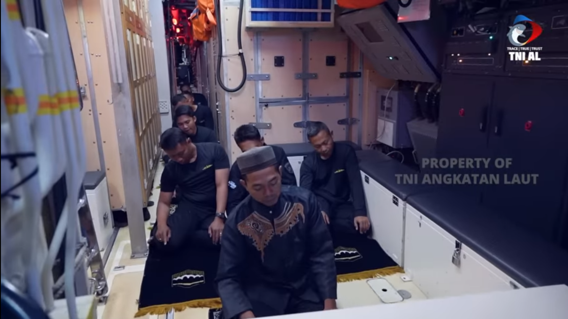

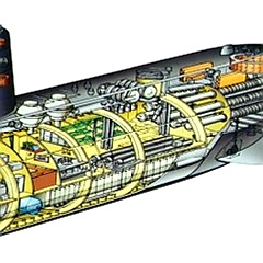

uhm guys, i think i made a mistake, and i would like to apologize for it, i'm sorry for the wrong information i shared to you, i just realized it when i saw this photos
this room is way more spacious than this
This indicates that there is room enough to store the 6 meter long Torpedo
As the cutaway illustrated it
Explanation :

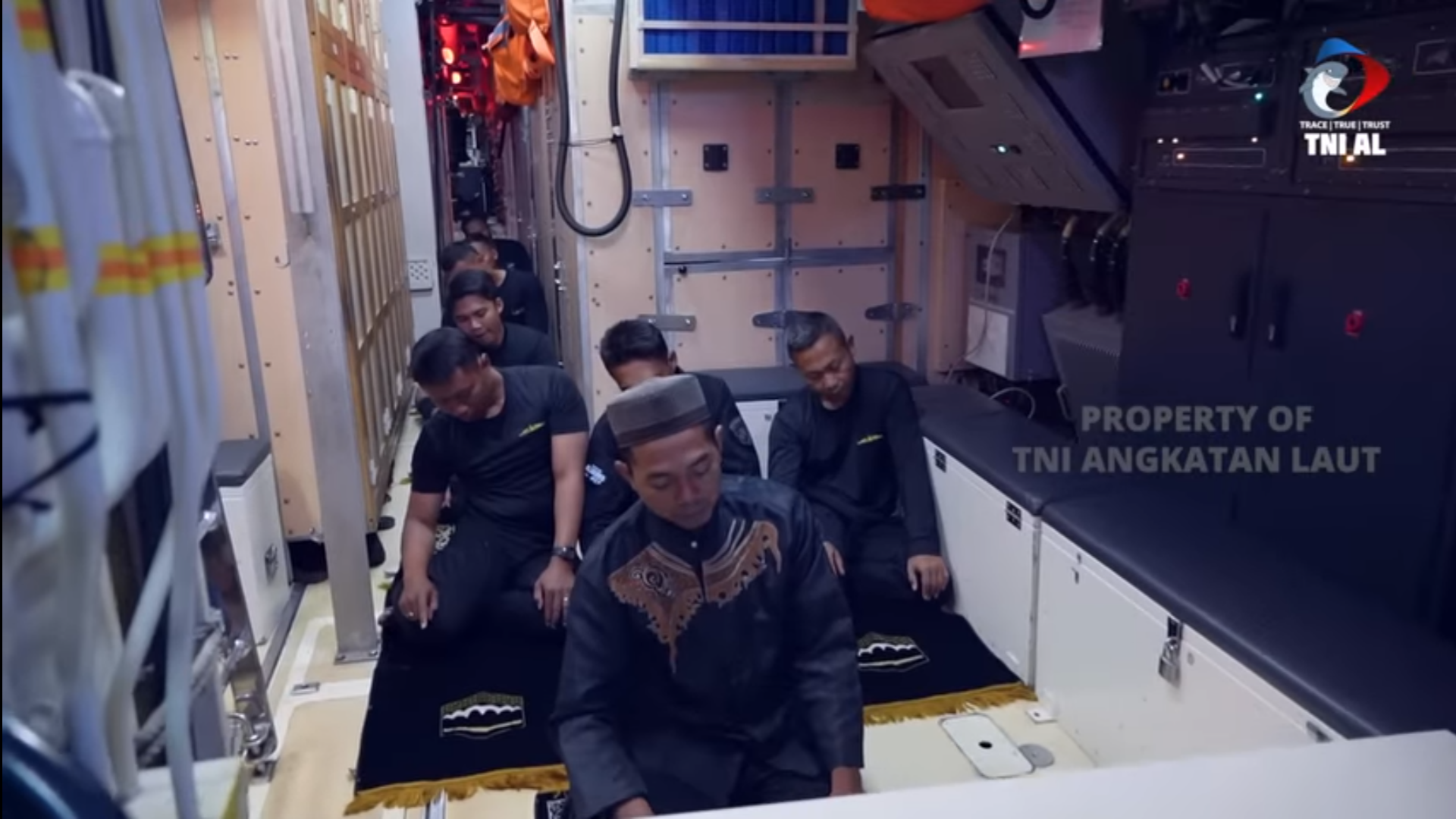

1. The Crew Compartment, especially the bunk and the closet as shown on the picture when the crew do the prayer (is the left side of the ship) is side by side with the more spacious room intended for torpedo storage

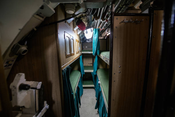

2. The submarine has 2 similar layout Bunk (as shown in the cutaway) which is looked like this
can complement about 12-16 crew can do the recess while the other is doing their shift. This kind of layout is enough for the 32+ crew onboard as they all don't need to have their own 32 bunk because half or 2/3 of them is on their shift
This explanation is perfectly match the specification.
Once again, i do apologies, Thankyou

uhm guys, i think i made a mistake, and i would like to apologize for it, i'm sorry for the wrong information i shared to you, i just realized it when i saw this photos View attachment 58141
As the cutaway illustrated it View attachment 58143
Explanation :
2. The submarine has 2 similar layout Bunk (as shown in the cutaway) which is looked like this View attachment 58144
