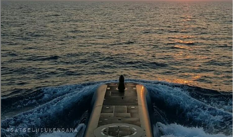

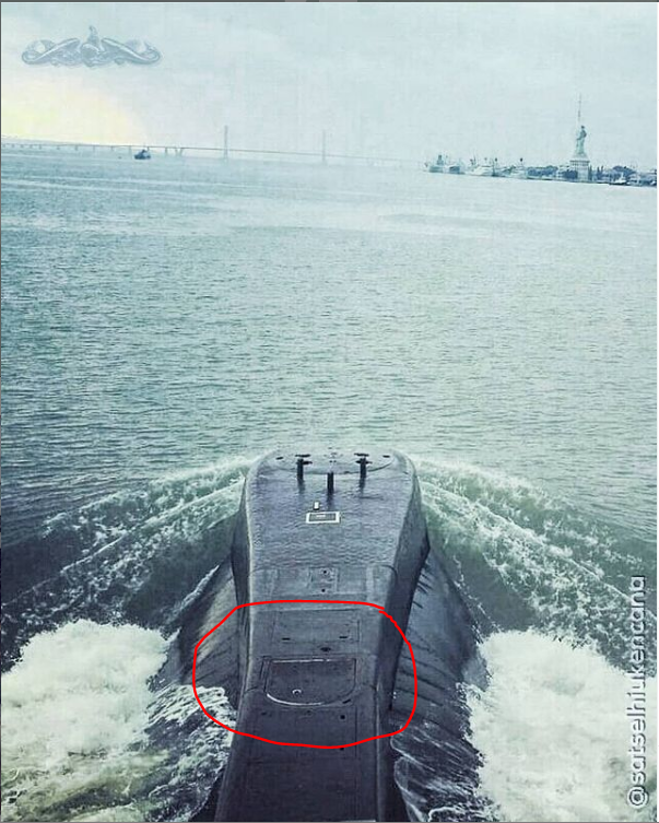

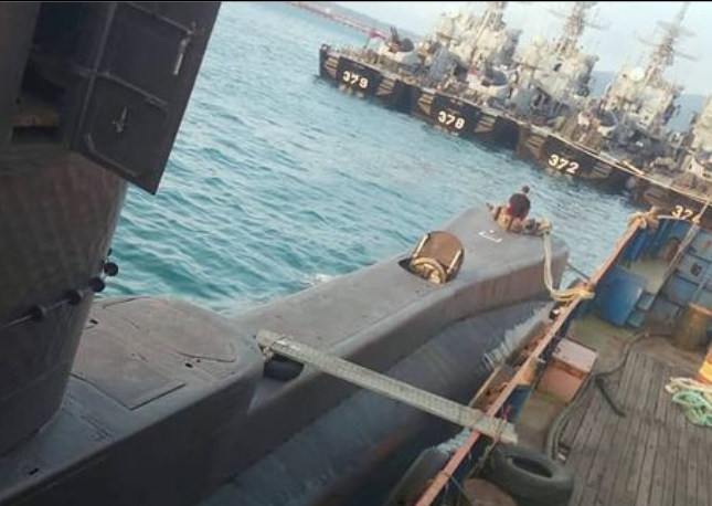

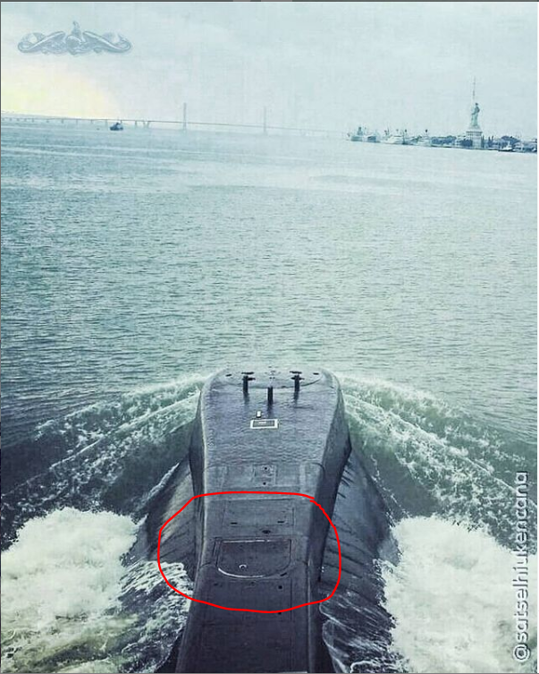

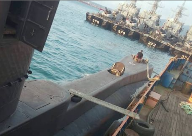

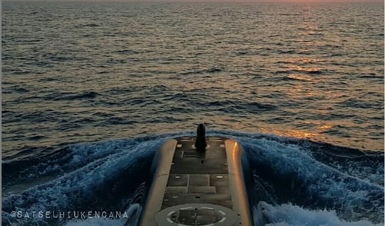

just from my observation, what your guys opinion on this?
this is cakra class (didn't know which sub)
another one when open
compared them with kri ardadedali
the hatch probably the same size but look at the ring around ardadedali and compared them to cakra class who dont have ring around it.
is it possible that DSRV to mate with naggala (hopefully can)?
just need your opinion on this
is it possible that DSRV to mate with naggala?
yes i just noticed it, the outer part of nanggala is narrower than ardadedali has, now i myself not so sure wether dsrv can intact properly on this sub or not:)

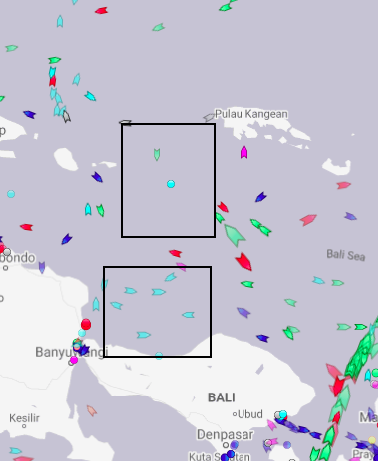

Which one is the actual SAR site?
the lower rectangle is where most of warships concentrate on,
While upper rectangle seems empty but shipping route is still on, ships are not re-routed.
Why aren't they still declaring a no-entry zone between kangean and bali for SAR?
torpedo loading hatch, it is common in most of the subs and doesn't exceed a diameter.
torpedo room is one of the escape compartments thus this hatch can be used for those purposes.
Another escape compartment is on the aft, engine room there should be a hatch as well but i am unsure for Type209/1300.
DSRV can either dock at such flat places or special bolted locations. procedures are different but it is just a detail.
Just ignore people who talks about incompatibility, it is a tiny detail moreover a useless one, which has no affect at the moment.
I think it is still possible (and I hope its possible, also hoping the marvelousness of German engineering so the boat still survive at those depth), but the operator need to be extra careful.
In nagapasa class its wider and have "the circle line thing" to help the operator position the dsrv, like a parking line.
Why declaring no-entry zone when they themselves unsure where the sub is?

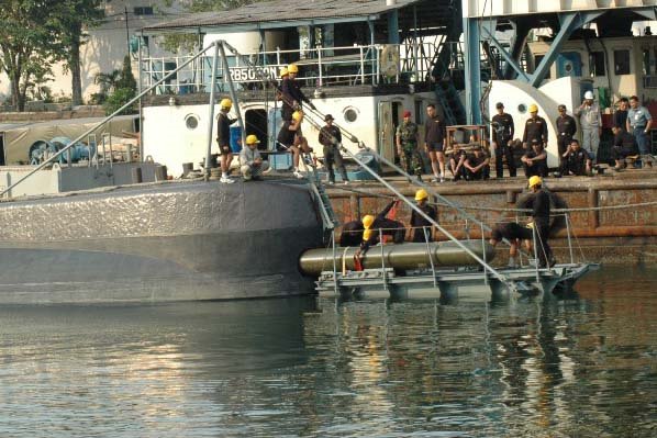

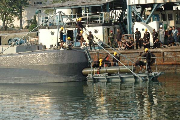

i dont think that torpedo loading hatch because on cakra class they load the torpedo through torpedo tube.
CMIIW
CMIIW
Maybe for convenience, the torpedo hatch is definitely used for that purpose since WWII.
They are directly loading a torpedo tube in the picture, not replenishing the storage.
