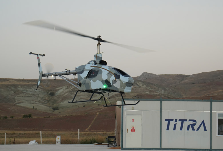

It was decided to support Titra Teknoloji, which operates in the fields of unmanned systems and artificial intelligence, in the "regional-priority investment" category of its investment in the manufacturing of air and space vehicles in Ankara-Kahramankazan.
Titra Teknoloji aims to produce 10 Alpin unmanned helicopters and 250 fixed wing kamikazes per year at the facility.
Alpin unmanned helicopter was created as an unmanned/autonomous solution by changing the control mechanisms and interfaces of the double manned helicopter and controlling the system-specific servo actuators with the developed autopilot system.
Alpin, which can take off and land vertically with a single button, aims to be the first mass-produced unmanned helicopter in Turkey that can perform assigned tasks fully automatically and can carry +200 kilograms of payload. With this load capacity, Alpin will be able to serve in many military/civilian areas.
With its fixed wing kamikaze solution, Titra Teknoloji also aims to respond to the increasing demands in this field recently.
Alpin unmanned helicopter preparing to take to the field for military logistics missions this year, will also be equipped with weapon systems such as missiles and rockets with its high payload capacity.

ALPIN Unmanned Helicopter is an unmanned aerial vehicle that is dehumanized/autonomous by changing the control mechanisms and interfaces of a double manned helicopter and controlling the system-specific servo actuators with the autopilot system developed.
ALPIN is the first unmanned helicopter in Turkey that can perform the assigned tasks fully automatically and can carry a payload of 200 kg including fuel. With this load capacity, ALPIN will be able to serve in many military/civilian areas.
