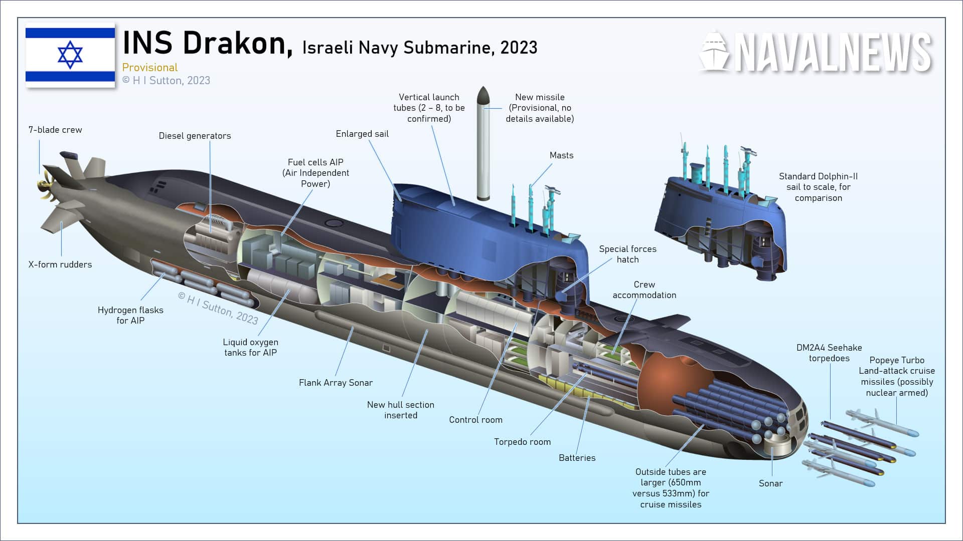

F3mL9TyXAAEJ_lS
INS Drakon is larger than any previous Israeli submarine, being much longer than the first two Dolphin-II boats. Even more noticeable is the ginormous sail. This likely contains its defining feature: advanced new missiles.
Submarines have been equipped with missile silos in the sail before. The Soviet Union’s first purpose built ballistic missile submarines, the Hotel and Golf classes, did this. More recently North Korea has leveraged this trick to get larger missiles into smaller submarines. Yet the German-designed submarine is the first truly modern design to feature this.
5,139
104 10,047
Nuclear tipped SLBM.
4,195
127 19,058
VLS for what? İt is being said that there will be SAMs.
Probably in the form of IDAS. VLS is more than likely for quasi ballistic or cruise missiles like their enlarged 650mm torpedo tubes.
