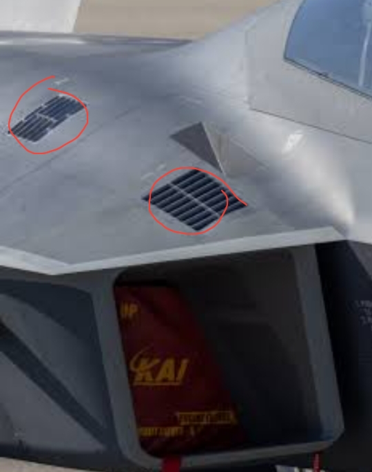

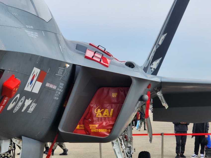

Anyone knew the purpose of these thing? The thing that look like intake louvers (gills) in Mig 29.

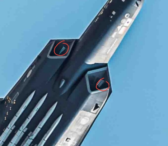

View attachment 74857 View attachment 74858
Someone told me that it's an outlet for the Boundary Layer, which is completely different from the one on the MIG-29.
The grilles further back in the second photo are called air ducts for cooling internal electronics, circulating air in the cockpit, etc.

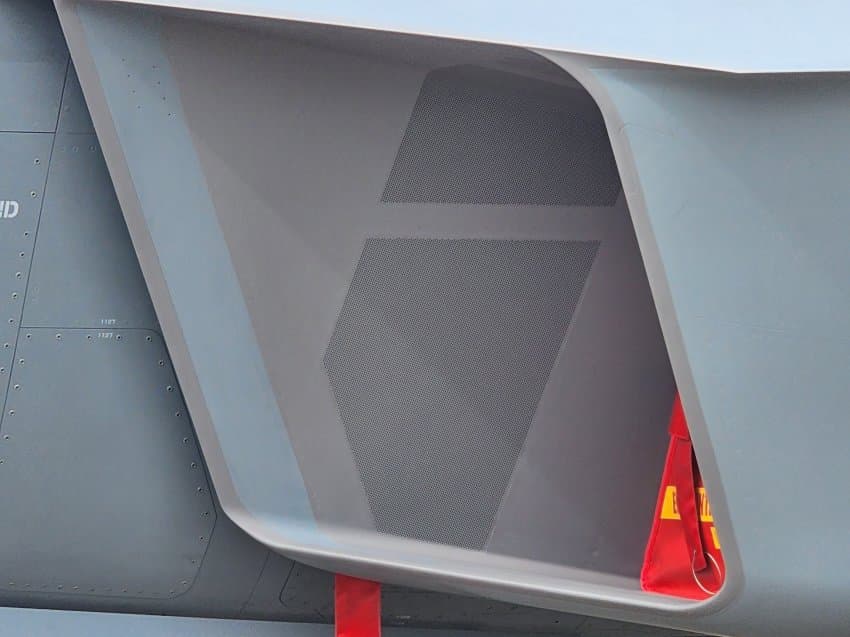

Outlet? I wonder how its work.
KF-21 air intake is caret style like F22, so its should be able to separate boundary layer air by its own.
For EF it got splitter plate to separate boundary layer, also have many small holes on them that help suck boundary layer.
960px-Eurofighter_EFA-2000_Typhoon_DA1_98%2B29_Intake_DMFO_10June2013_%2814563817746%29.jpg
But KF21 holes is straight thru/penetrate the top area of air intake, while EF holes(boundary layer suction/bleed) is just at the bottom of the splitter.

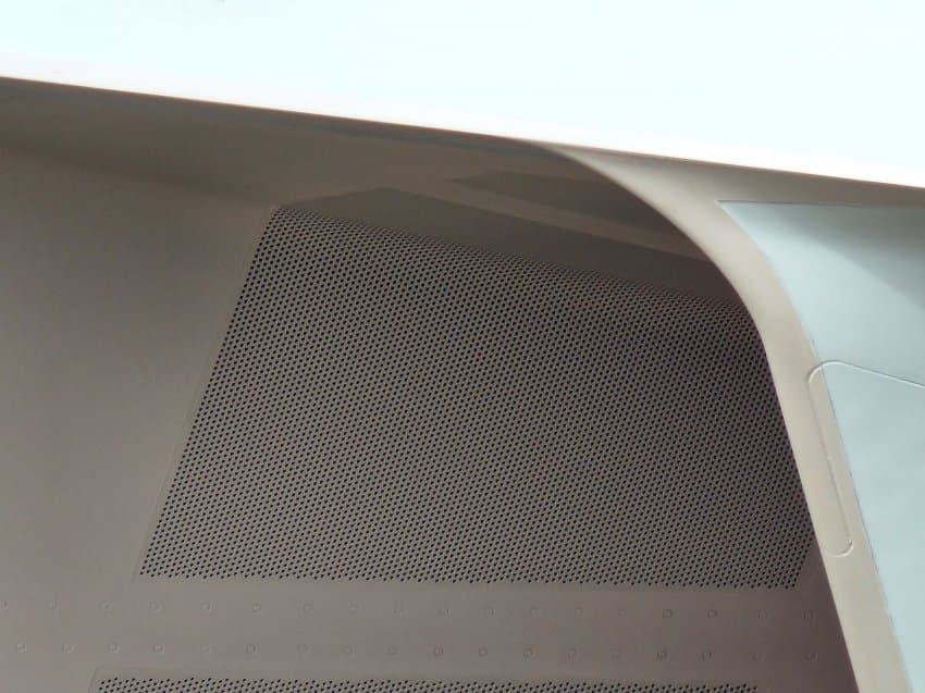

To be honest, I'm not confident because I don't have the knowledge to give you a professional explanation, maybe the word Outlet is wrong, but .... Anyway, I'll show you a picture of the space that separates the boundary layer.
A better way to describe it would be that it's an air hole that lets the air out after the boundary layer is separated. And then... I hope someone else can explain it~.
3,550
5 3,234
For stealth fighter usually, the design(surface) try to be sleek and smooth, angled etc. And that pic with so many tiny holes, wonder if it will affect RCS, its mostly covered but from certain angle its still exposed outside.
That's why we wanted to develop Block 3. I've heard that the F-22 has a lot of holes, but the reason they look so smooth is because they're covered with very thin mesh.

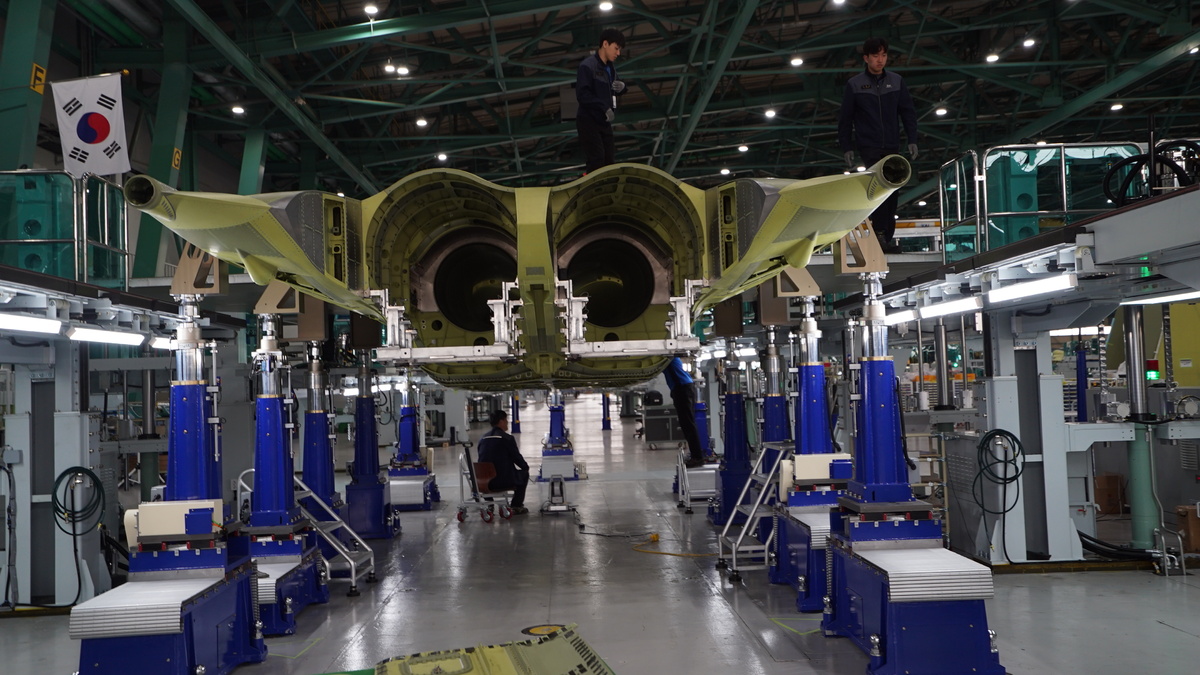

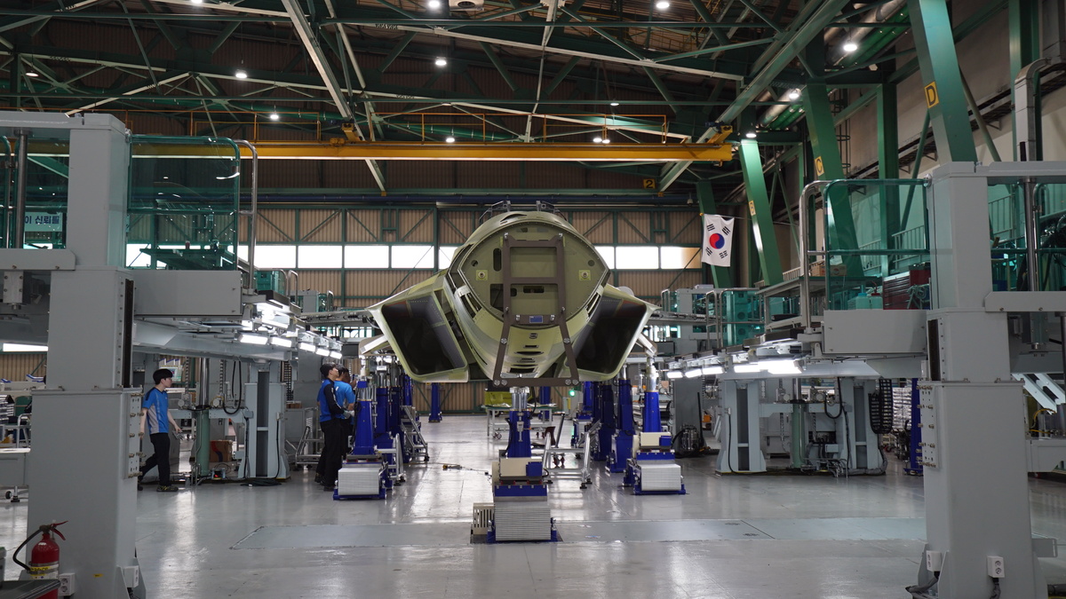

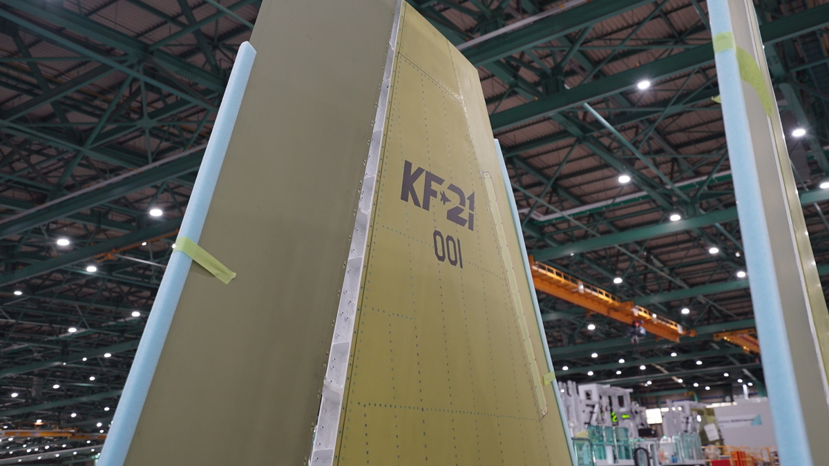

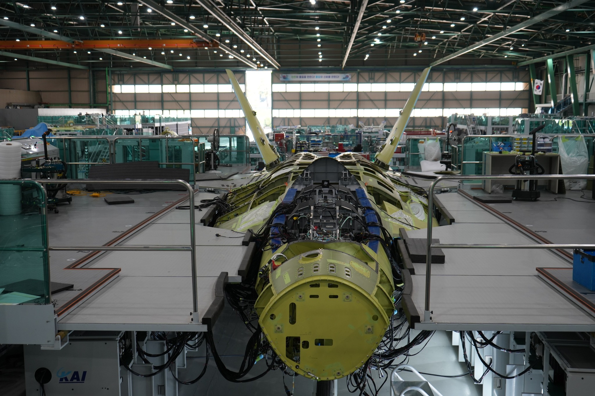

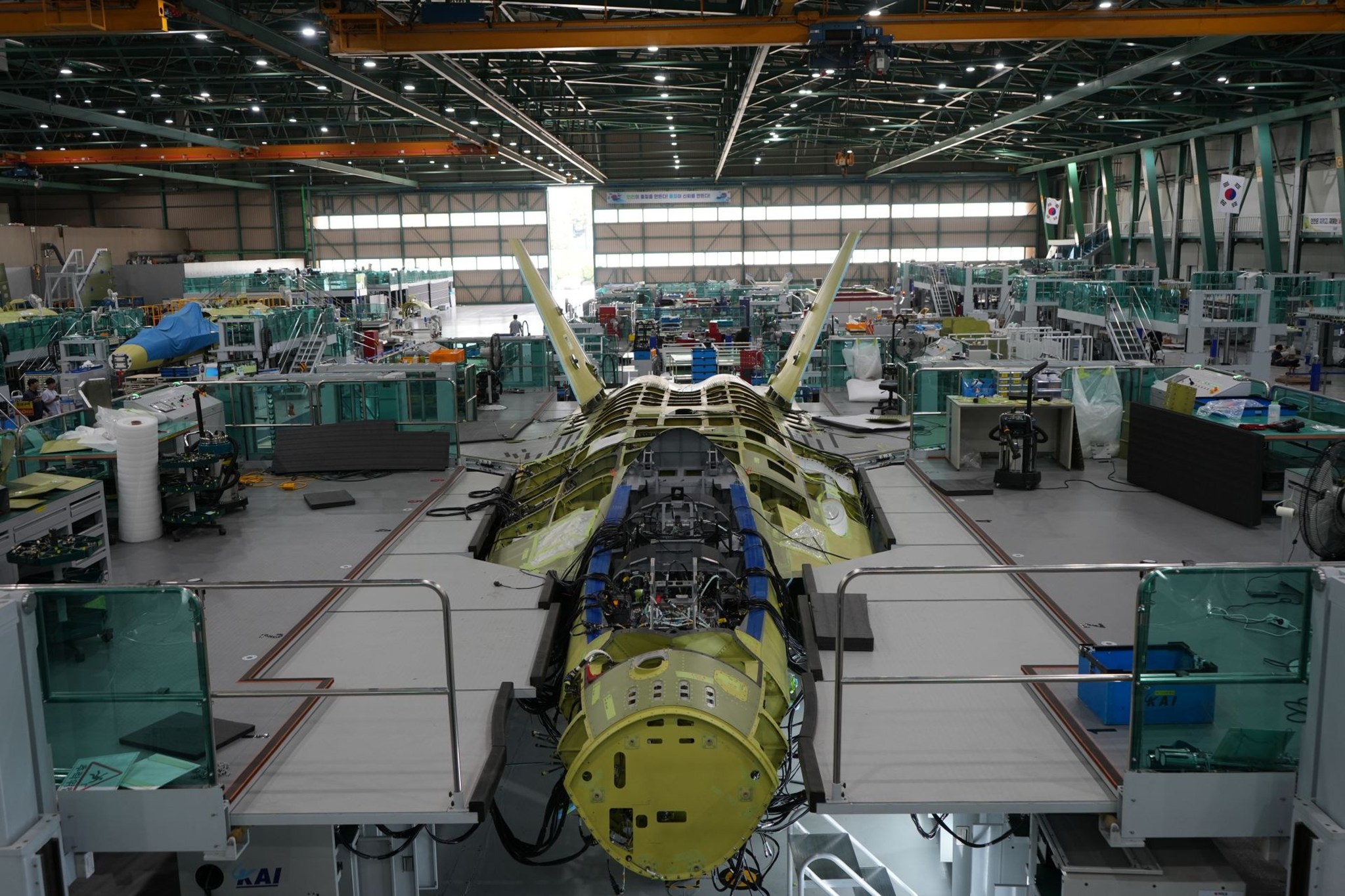

The first mass- production model KF-21 has entered the final assembly phase. Assembly of the 12th unit has now begun, and a contract for the second batch of 20 Block1 is expected to be signed in June.

A time-lapse video of the first assembly to the start of the final assembly phase. The video shows the machining of parts, fabrication of critical components and assembly of the front, center and rear fuselage of the first KF-21 mass-produced aircraft over a period of about 10 months from June last year to April this year. According to DAPA, about 260 workers were involved in the assembly work in the video, and about 100 more will be involved in the 'final assembly' stage starting. The KF-21, which entered mass production in the second half of last year, will enter the final assembly stage , where wings will be attached to the fuselage, electronics and engines will be installed, and various equipment will be tested for normal operation.
