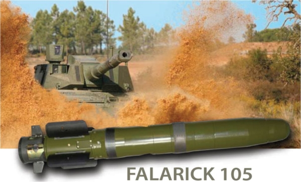

I guess this is very good reason not to use Tanok or Lahat like missiles!! M63, the 105mm main gun of M60 is “rifled”
We had already discussed it. Ukraine produces Falarick laser guided missiles for rifled 105 mm guns.
Cockerill CMİ 105mm turrets use it.
4,305
274 22,501
There is a lot to share with and learn from these Ukrainians. I hope MKEK or Roketsan start developing these with our neighbour across the water.
