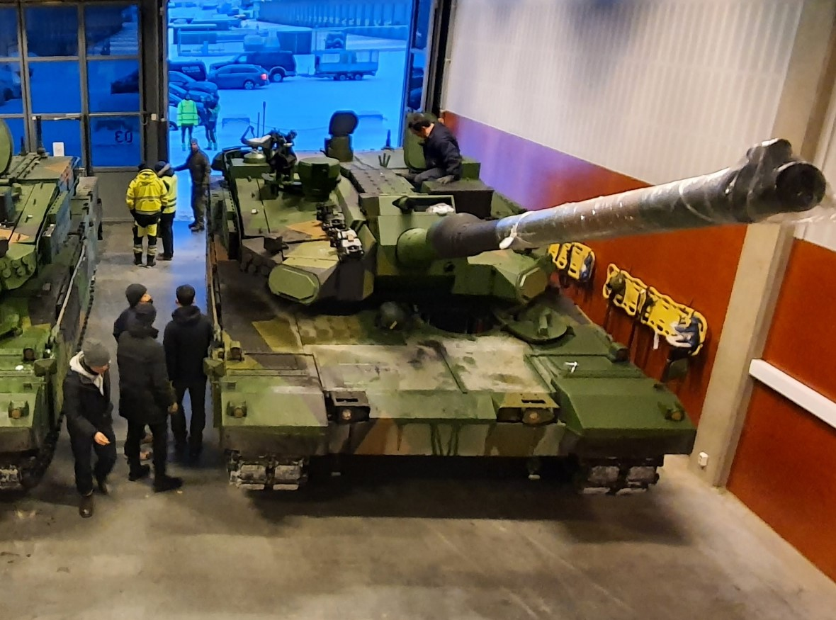

Where did you get these sources? Wait, the K2 on the left side of the picture seems to be the original K2 used by the Korean military, but why did the original K2 come to Norway with K2NO? Do you know anything about this?

Could it be that they're not in Germany yet ?
K2 looks very sleek. Did it have active protection system, and where is it located ?
That's the APS search radar in front of the tank turret. But that seems to be a Laser jamming APS, not a Hard-kill APS.
A Hyundai Rotem official said that the K2NO currently being tested contains Rafael's Trophy APS, but Elbit's Iron fist APS may be mounted later. Perhaps at the request of the Norwegian army, Rafael's trophy or Elbit's Iron fist will be mounted on the K2NO.
The last prototype of the K2, unveiled in 2007, was mounted with a search & tracking radar for Hard-Kill APS on the front of the turret, and a grenade launcher was mounted at the top of the turret to neutralize explosives such as RPG.
Currently produced K2 is mounted with only laser jamming radar to neutralize Anti-tank guided missile (ATGM) on the front of the turret, excluding Hard-Kill APS.

December 28 th 2021, at noon, universal time, the Platinum Ray car carrier (under the Bahamas flag) entered the Norwegian port of Drammen in the Buskerud province, on board of which there were two South Korean K2NO tanks, belonging to the Hyundai Rotem company, which will undergo evaluation tests as part of the procedure for the successor of 52 Leopard 2A4NOs. One is with the hard-kill Trophy VPS system and the other K2NO with the soft-kill system only. K2NO was presented at the 13th ADEX (International Aerospace & Defense Exhibition) in Seoul, October 19-23. The tank received reactive armuor, the Rafael Trophy hard-kill Israeli active vehicle protection system (VPS) and the Norwegian Kongsberg Protector RS4 remote-controlled weapon module with a 12.7 mm machine gun. Then, after the completion of the delivery program, the Koreans offered the Norwegians to jointly develop a deeply modernized K3 tank with an unmanned turret and 130mm smoothbore cannon, and an improved suspension that could be built in the mid-2030s.
