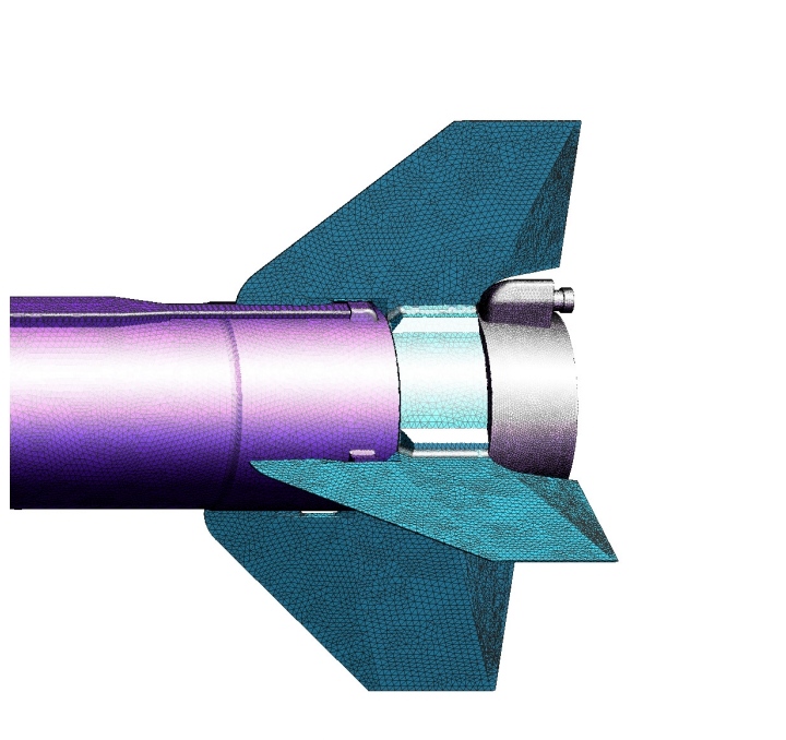

Back end is not fixed. The fins at the back are tilted and rotate to stabilise flight. Canard controlled rockets may need rotating tail fins for flight stabilisation.
Canard-controlled missiles are commonly used by designers. These missiles have, induced roll problem generated by the canard tip vortices. The idea of free- to-rotate tail fins has been used by designers of missiles. NASA too tested a number of roll-control devices as part of their aerodynamic research program. Tests were conducted with missile airframes having free-to-rotate tail fins, not only to stabilize the missile longitudinally but also eliminate unwanted induced rolling moments that were generated.
Thank, and how they change direction in flight? How actuators works in this rolling configuration ?
The canard control missiles of this ilk have “free-to-rotate” tail fins. They do not have actuators. If you watch carefully in slow mo, the tail fin rotates freely. Due to the tilted aerodynamic construction of the tail fins the induced tail fin rolling moment opposes the direct canard control and actually causes the overall rolling moment to oppose the intent of the canard deflection. Hence stabilising longitudinal flight.

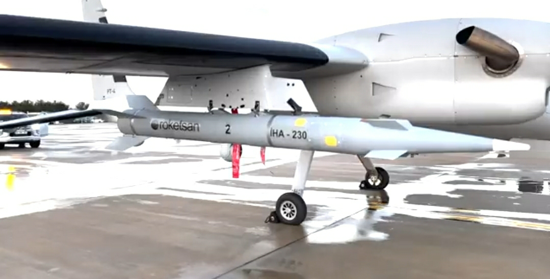

Just as a side note, to those comparing Roketsan IHA-230 (230mm diameter) to Elbits Rampage (306mm diameter;
IHA230 is going to be around 215kg whilst Rampage rocket is 580kg.
So quite the size and weight disconnect between the two, even though they both are similar types of missiles.

Thank you, that was very interesting.
So, TRG missiles are canard controlled with spinning stabilization fins in the tail!
@Yasar sorry to disturb you again!
But these canards looks like fixed to me.
Any explanation?
Believe me they are attached and controlled. Zoom a little you will notice that they are. Roketsan's engineering capability is so good that you can't tell the canard are attached.
