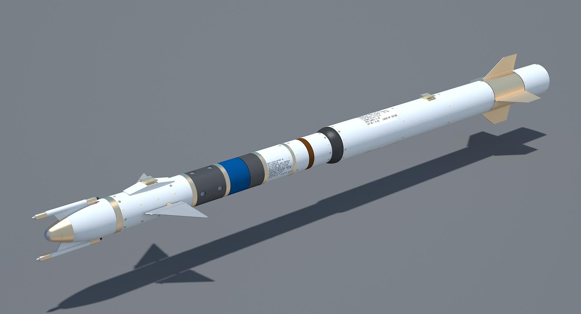

"Off-Boresight" missile technology means that before launch the missile's radar or IR sensor can be cued to a target considerably off the nose of the launcher"
My question is : Could UMTAS and SUNGUR be cued to target before launch just with the software upgrades? İf yes , Turkish Navy's warships could launch UMTAS as well as SUNGUR vertically using data from Radars, isn't it?
Or the missile needs onboard inertial navigation system (INS) to navigate towards the target?
I don't think Hellfire has INS but somehow it can be vertically launched.
How Hellfire can be launched from VLS, crazy.
@Yasar Dear again me asking
Umtas specifications indicate a flight envelope that covers wide off boresight target acquisition.
Our new longer range version of this missile, most likely, will also have the same capability. These missiles are fire and forget type missiles.
Sungur is also a fire and forget type missile, specifically designed against aerial threats with very high manoeurability.
A missile's/projectile's range is longest when launched at 45 degrees. Any deviation from this angle will decrease range. Hence vertical launching is detrimental to range.
Umtas and Sungur are missiles that are designed for launching at an angle. In fact Umtas is also designed to be launched from helicopters against land targets. But they can be launched vertically too if the kinematics and the design will permit. At worst it is a matter of re engineering to serve that purpose.

81 45,473
UMTAS-GM-1
  • IIR and Semi Active laser
  • 41,3kg missile weight
  • 1,72m missile lenght
  • 160mm diameter
  • 16km range from land vehicles
  • 20+km from helicopters
First quarter of 2024, GM1 semi active laser variant, final quarter of 2024, GM1 IIR variant with two way datalink will be in inventory.
