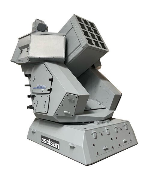

GÖKSUR uses the BOZDOĞAN missile, developed by TÜBİTAK-SAGE and updated according to the air defense needs of naval platforms, as an interceptor missile. GÖKSUR Close Air Defense Missile System is being developed in the product family setup and offers a solution with three different configurations with a modular design approach.
-Multiple Target Interception Capability,
-stand alone and/or Platform Integrated Operation,
-terminal guadiance with data link

Göksur will be more capable then RAM. Kinda horizontal launched Hisar A
