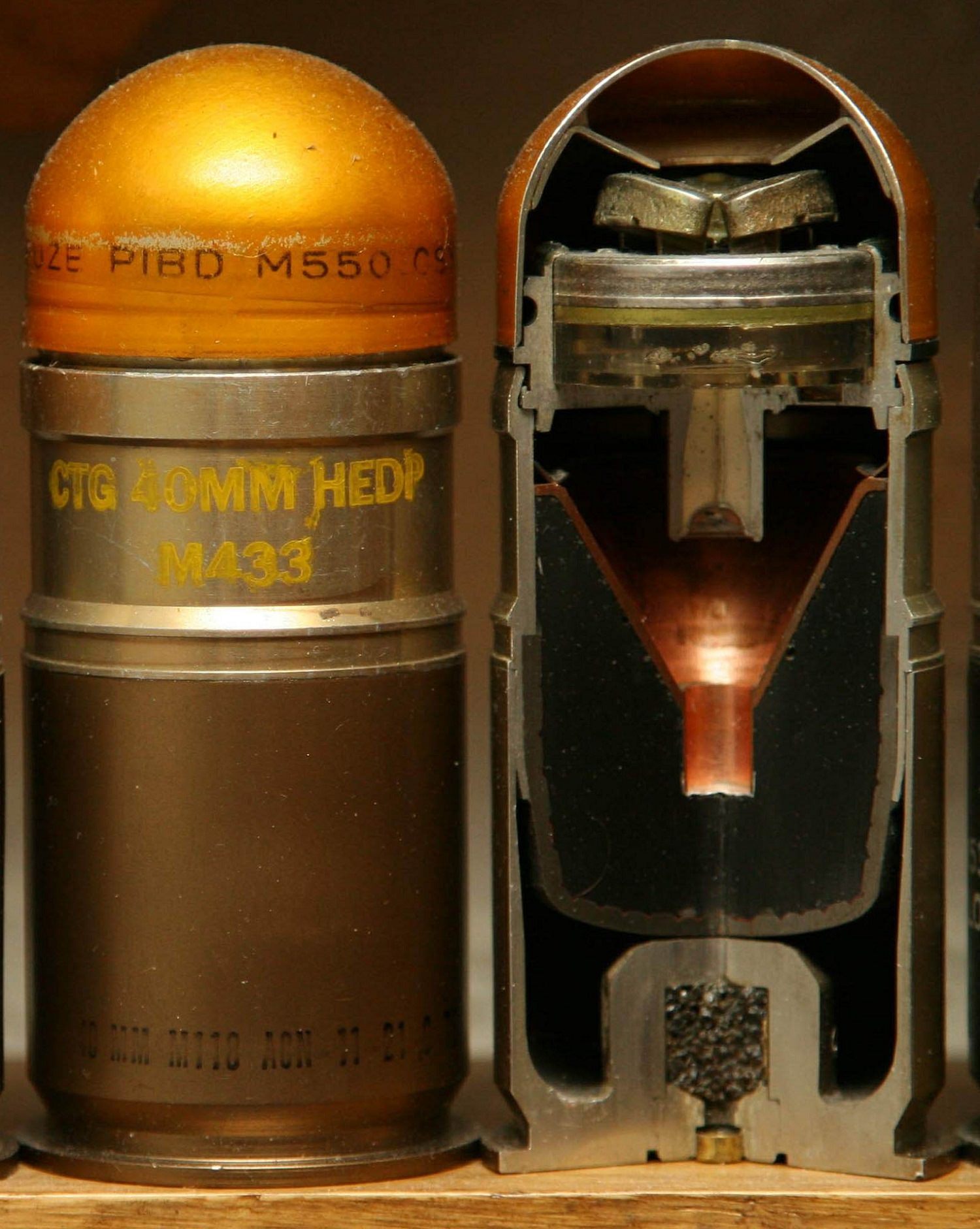

Congratulations my friend. Because you can weigh the CIDA on the same scale with a 40mm ammunition that can penetrate the 5cm thick historic STEEL ARMOR at a distance of 27m at 5m diameter.
Yes, because we know that Cirit Tri-Mode warhead is capable of penetrating 3cm.
